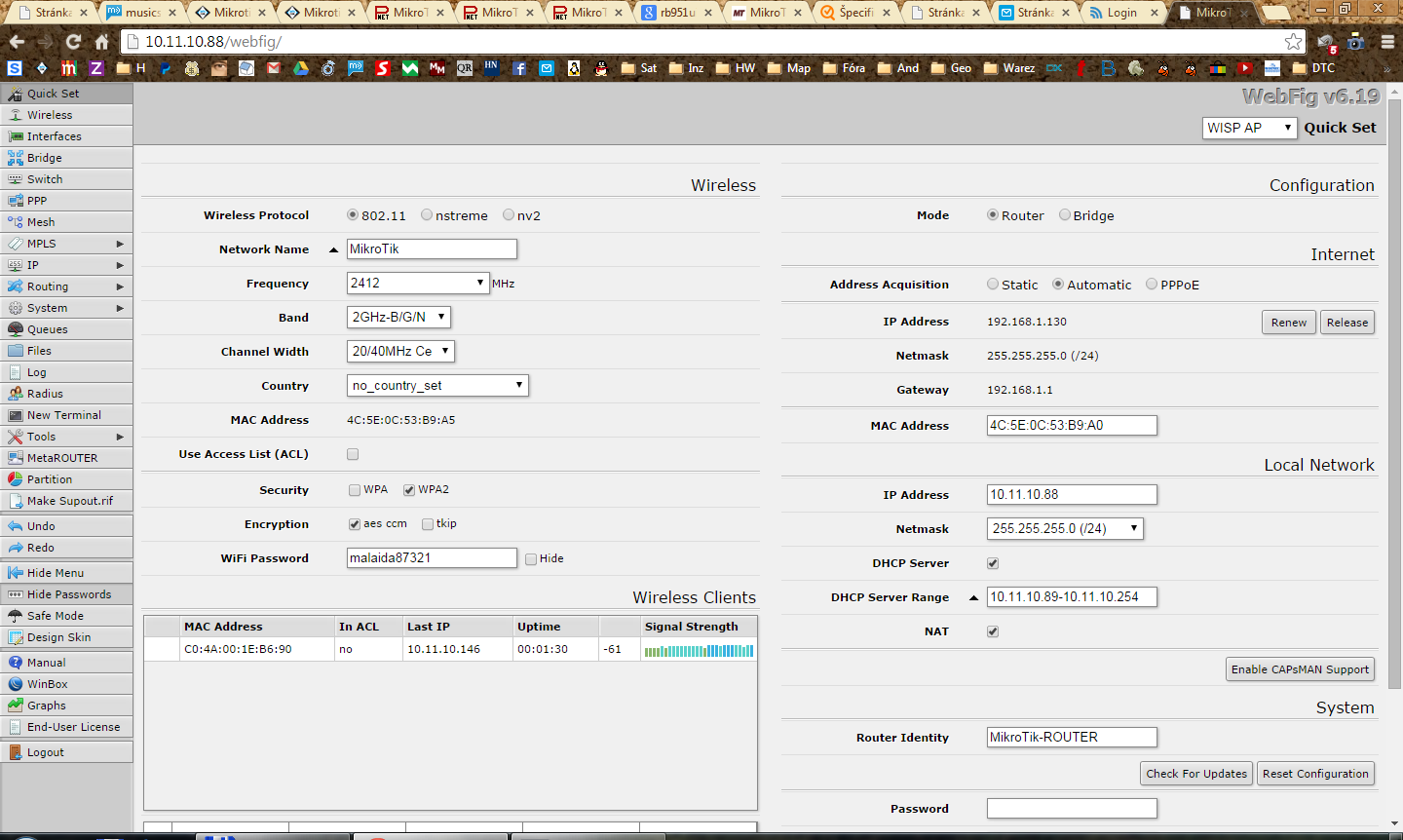

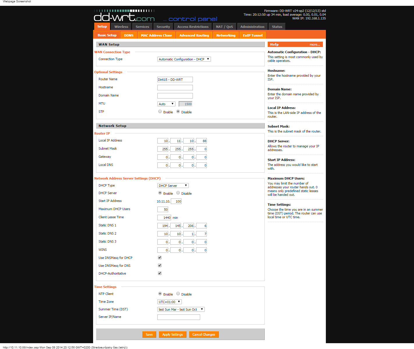

I am beginer. I have D-Link DIR-615 with DD-WRT firmware, it works fine. I want to change it to MikroTik RB951Ui-2HnD, but it not works good. For some minutes it work but after some minutes I can not connect to internet.
At the image I show my configuration at DD-WRT, and on the second image configuration on MikroTik.
Where I make mistake?
Can someone send me screenshots with this corrent configuration in MikroTik? Or backup with configuration for me.
Is DNS compulsorily?
Sorry if my question is stupid :confused:
Thank you for your help.

Look at this website en try this.
In dutch but look at printscreens a made
http://www.wirelessinfo.be/index.php/mikrotik/pages/dns
You must reconfigure the DHCP server with as first DNS-server the IP-address of your router
if you already have dhcp-serve configured, you can head over to /ip dhcp-server network and configure entry there, set router ip as a dns address. Renew dhcp lease on the host.
