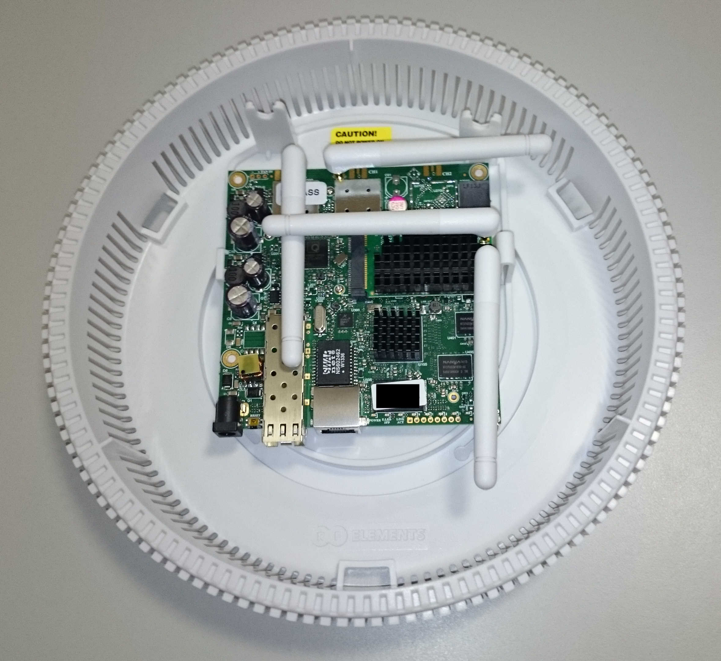

FYI: Photo of RB922 + R11e + enclosure StationBox InSpot
I was looking for a while for a dual-band solution and enclosure and, finally, here is the result.
  • MikroTik RB922UAGS-5HPacD
  • MikroTik R11e-2HnD
  • RF elements StationBox InSpot
  • RF elements Antenna Omni-Directional Dual-Band 2.4GHz/2dBi 5GHz/3dBi OARDSBX-DUAL25
Enjoy.
Cool, thank you for showing! :smiley:
Please, post more photos.
Nice one
We have a whole bunch of those StationBoxes at a client with RB951’s inside and they work a treat.
Thanks for sharing
This mmcx antennas are ideal for inspot (no pigtails)
http://www.rfelements.com/assets/sheets/AntennaOmni242-53_Datasheet.pdf
Very nice.
See also product gallery :slight_smile:

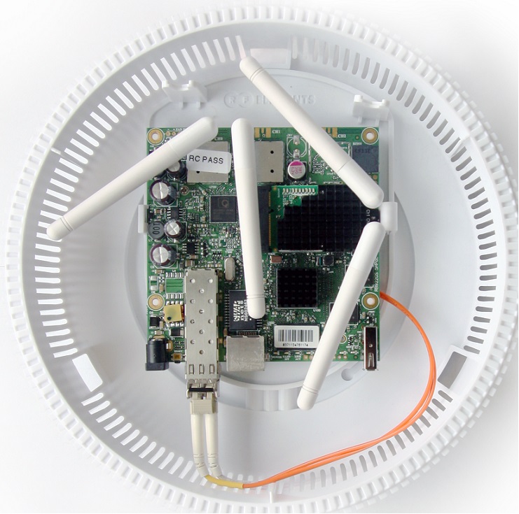

With fibre connection
I think you need some power, to make it work. :slight_smile:
It is new standard - powered via fiber cable :smiley:
sure.. PoF :laughing:

nice setup, i am figuring how to obtain all the pieces on my country
whats your opinion of an alternative using basebox 2 + R11e-5HacD some similar to this??
http://solimedia.net/mikrotik-wireless-solutions/205-basebox-pro-5-24.html
can be cheaper to assemble? taking in count base box comes with power supply, poe injector and a case.
But basebox need different antennas and 2 pigtails.
