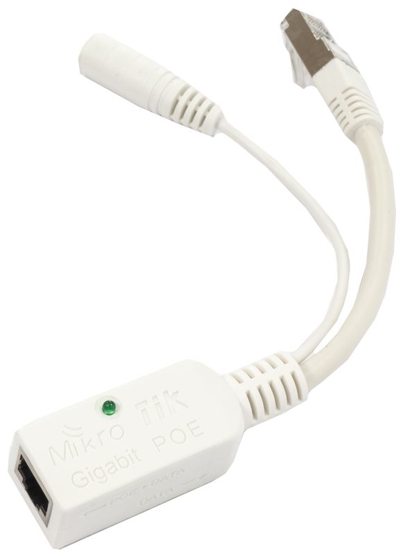

But make the cables a couple of meters long, or put any make or type (all Gigabit type) power shot in between two Gigabit routers and I get only sometimes a gigabit connection. Or it runs for months and then never to be able to get them back again as gigabit. Even not when forced. 100Mb is fine though…
Usually I refer to cables that also has to do PoE. On most Gigabit units nowadays its even not to be avoided to use same network cable for poe and data connection.
