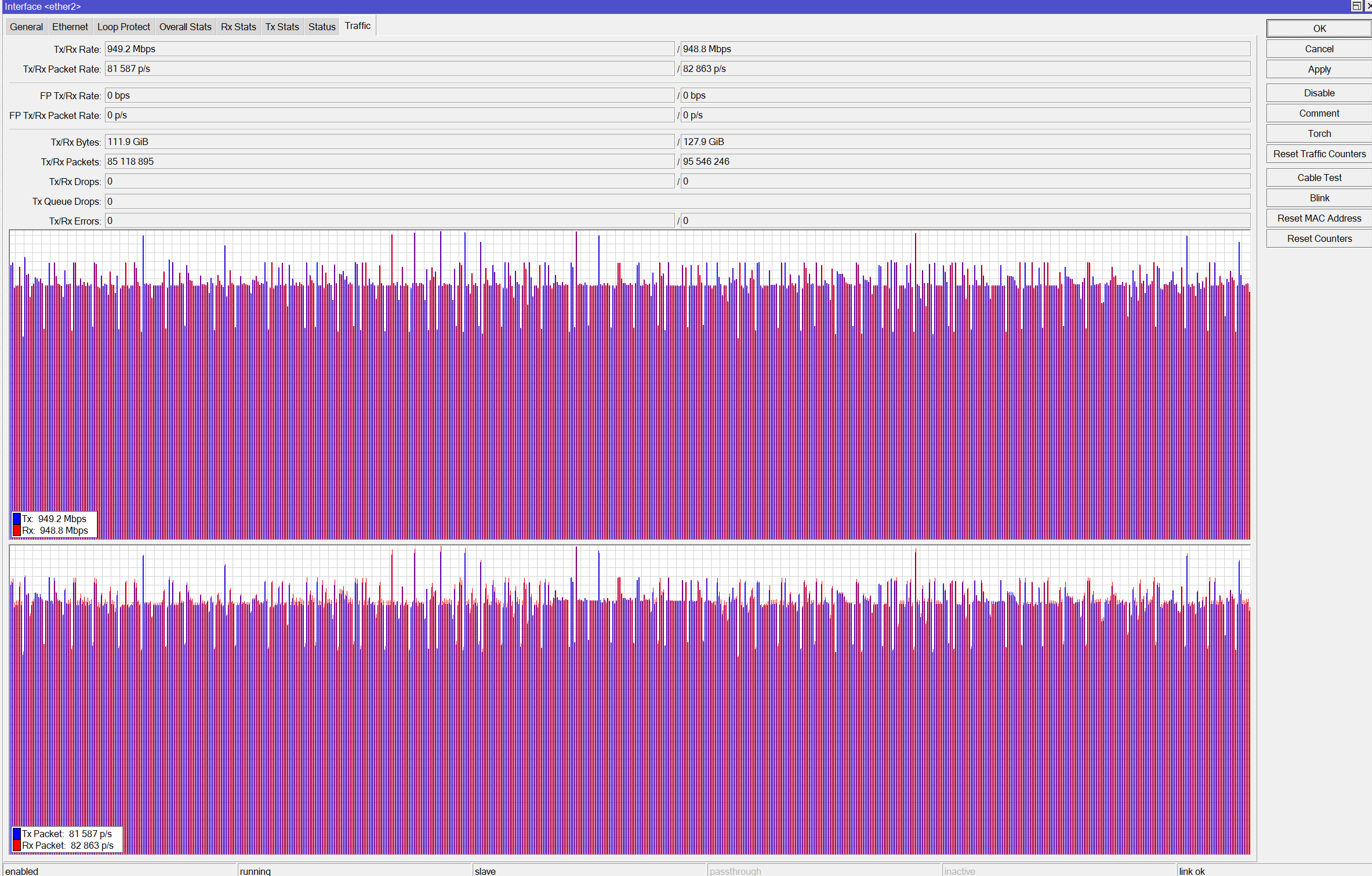

Just want to let you know my last findings here.
I've simplified the config as much as possible (see below for details):
  • ether1 is LAN
  • ether2-5 is bridgeWAN
  • Disabled/secured everything I do not need.
Thats it.
Then I setup two of my old laptops with integrated GBit NIC with Antix-Linux so I can run iperf3 in bidirectional mode to its fullest.
Apparently running iperf3 on Windows does lack the performance and stability :frowning:
Tested this iperf3-test-combo with an unmanaged d-link dgs-105gl and a Mikrotik RB260GS. Got constant 111MByte/s in each direction.
Now to the HexS:
Leaving ether4+5 still connected to my Fritzbox-WAN and ONT I connected the iperf3-test-combo to ether2+3 and started iperf3 -c 192.168.0.1 -t 0 --bidir and the tranfer was table at 111MBit/s as well :partying_face:
Monitoring ether2 with winbox looked like that:
It is still not perfect as the rate drops to 800MBit/s every couple of seconds but way better then when I started this thread.

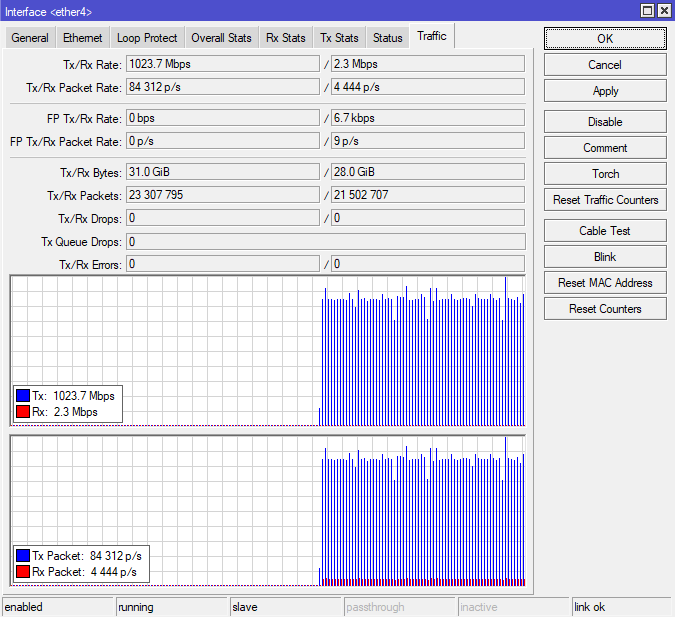

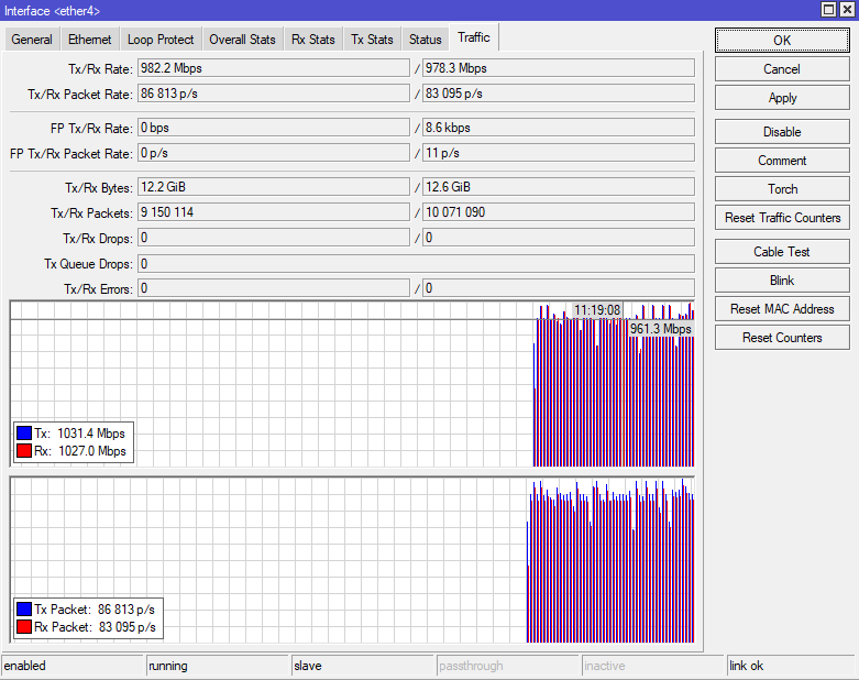

I tried it on my hEX Refresh, I just connected it between my computer and the network,
I see that the overall speed is about 960 Mbps, but on the graph there are some dips up to 830 Mbps, in one direction there are also dips, but less often, I used iperf3.18_64
