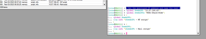

I have a script that has been working for a couple years that pings a few IPs and wrote the results to the log and sends an E-Mail if the pings were excessive.
Last year with help from Rextended (that you sir), the original script was modified so that instead of writing the results to the log, it wrote the results to a couple global variables and passed that to a second script that wrote the results to a file. I did it that way so I could reuse the Write To File script for several similar ping scripts. That also has been working. Then every few hours a third script would send the file via an E-Mail and then reset the log file to 0 bytes. That also has been working fine.
Now I’m trying to add a couple line header to the log file after it is reset to 0 bytes. The easiest way to get the data for that was from a couple of the variables in the original Ping Test script. OK, successfully changed the couple variables from local to global variables and the Ping Test scrip and the Write To File script are working perfectly. The Write to File script does not use the newly created global variables, but the Send the E-Mail script will need them.
The problem is that the E-Mail script is not getting the data from the global variable. As a test, I defined the global variable in the Write To File script and added a log entry of that variable. The correct data was put into the log - so I know the Ping Test script was properly creating the variable as a global. Added the same log entry to the E-Mail script, and it is blank. All three scripts have the same owner and the same permissions - read, write, & test. Here are a couple extracts of the three scripts.
Here the Ping Test script defines the global variables and sets data into them

So why does one work and the other not?
What RouterOS did you test it on?
I did cut and past all data to terminal (winth {} around the code} on a router running 7.6 and all works fine.

My error on that. This is on a RB4011GS+ running 6.49.6

I have been poking at this and may be onto something. Don’t have the resolution, but I’m down the right road - I think. Scopes.
The “AREDN ping test” script is started from the Scheduler.
The “WriteFunction” script is called from the “AREDN ping test” script - the global works
The “Mail AREDN Pings” script is started from the Scheduler - the global does not work.
As a test, I called the “Mail AREDN Pings” script from the “AREDN ping test” script - this time the global worked in the “Mail AREDN Pings” script.
So, it would appear that the global variable is still being limited by a scope. Does this seem to be a reasonable assumption? And how do I make the global variable truly global - or some other work around?
Success. I changed my concept a bit. Now, at the end of the “AREDN ping test”, it checks the size of the “AREDN_Ping.txt” file. If that file size exceeds 3900 bytes, it then calls the “Mail AREDN Pings” script. That apparently keeps the global variables in scope and it works.
