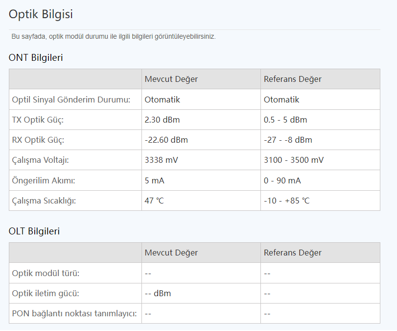

1 single fiber optic wire is connected to this device, current speed is 1 gigabit and I do not know its distance to the switchboard.
The ont field of the device panel contains the following information;
i have Mikrotik RB4011iGS+5HacQ2HnD-IN
without any compatibility issues which fiber module should I buy for this device, what should i pay attention to?
