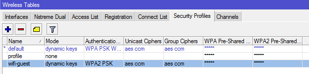

I’m now trying to configure the second AP, so it too would have the additional wifi for guests. While I was able to create a new Wifi Security Profile and the SSID is visible on my devices, I don’t get a IP from the DHCP server. Additionally manually setting the IP to the 172.168.0.0./24 network doesn’t help either, there’s no internet.

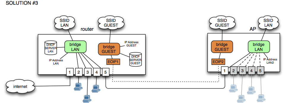

#3 [probably the easiest] configure 1 EOIP tunnel between the router and the AP to be used for guest wlan interconnect
router1 (just giving an example)
  • ether1 : internet
  • ether2-ether5: LAN (ether2 is the master port for ether3,ether4,ether5)
  • AP is connected to whichever ports in the LAN (ether2..ether5)
  • eoip1: eoip tunnel between the router and the ip (local address: router’s LAN IP, remote-address: AP’s IP address)
  • wlan1: main wireless interface used for LAN
  • wlan2: virtual AP, used for guest SSID
  • bridge-lan: connects wlan1, ether2 (and ether3 and ether4, ether5)
  • bridge-guest: connects wlan2 and eoip1
AP:
  • ether1..ether5: LAN, ether1 is the master port.
  • one of the ports is interconnected with the router
  • eoip1: eoip tunnel between the router and the ip (local address: AP’s LAN IP, remote-address: routers’s LAN IP address)
  • bridge-LAN: connects wlan1, ether1 (and ether2, ether3 and ether4, ether5) - this interface has IP address from the LAN subnet

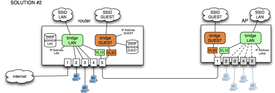

i created a quick overview of options #2 and #3.
i will do a detailed guide on the capsman version, as it might seem a bit complex for the first glance, but maybe easier to control/manage.
i’ll post it on my blog and drop a link here.
i will also include the configuration as well (probably for options #2 and #3 as well)

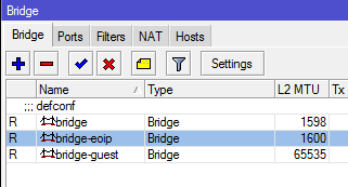

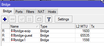

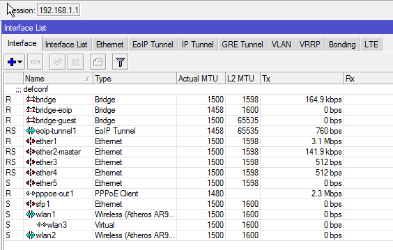

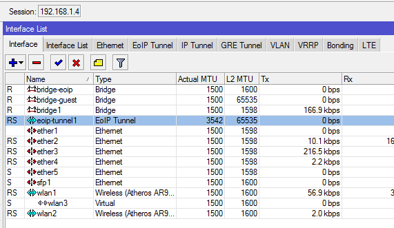

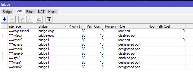

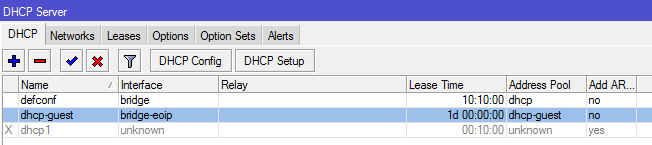

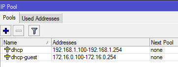

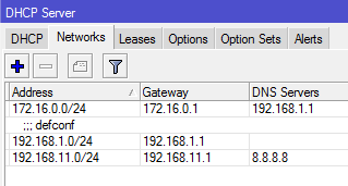

Wow, thank you so much for spending that much time on this, I really appreciate it. I tried to follow the 3rd option as much as I could, but the clients are still not getting an IP from the DHCP server (on router1).
I’m providing screenshots of the entire configuration, if that might help in assisting me (I think we’re quite close):
  • router1:
  • AP
    There are no DHCP settings on the AP, and there’s only the 192.168.1.0/24 network.
Please let me know if anything else might be required?
What tool are you using to draw diagrams? This is nice.
Excellent diagram! Very helpful.
