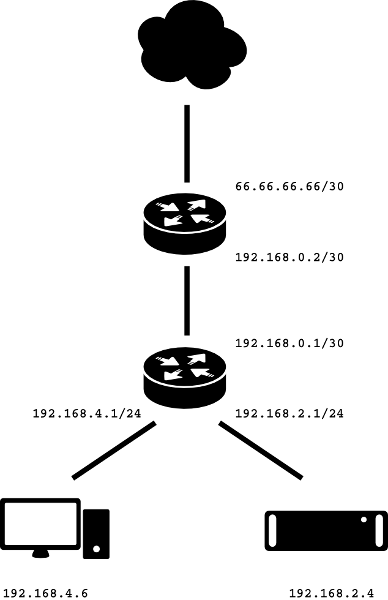

I noticed that hairpin NAT on single interface bypasses firewall.
Let’s assume following:
bottom router:
/ip address add address=192.168.0.1/30 interface=ether1
/ip address add address=192.168.4.1/24 interface=ether2
/ip address add address=192.168.2.1/24 interface=ether3
/ip firewall filter add chain=forward in-interface=ether2 out-interface=ether1 action=accept
/ip firewall filter add chain=forward in-interface=ether3 out-interface=ether1 action=accept
/ip firewall filter add chain=forward action=drop
/ip route add gateway=192.168.0.2
top router:
/ip address add address=66.66.66.66/30 interface=ether1
/ip address add address=192.168.0.2/24 interface=ether2
/ip firewall nat add chain=dstnat dst-address-type=local action=dst-nat to-address=192.168.2.4
/ip route add gateway=66.66.66.65
/ip route add 192.168.2.0/24 gateway=192.168.0.1
/ip route add 192.168.4.0/24 gateway=192.168.0.1
In such config even though top router in theory shouldn’t forward packets - it still does. While connection incoming from the outside won’t be forwarded, 192.168.4.6 can still access 192.168.2.4 using 66.66.66.66 address. I’m not 100% sure but I think this issue occurs only if out-interface is the same as in-interface after NAT.
I find it security issue.
Change my mind.
