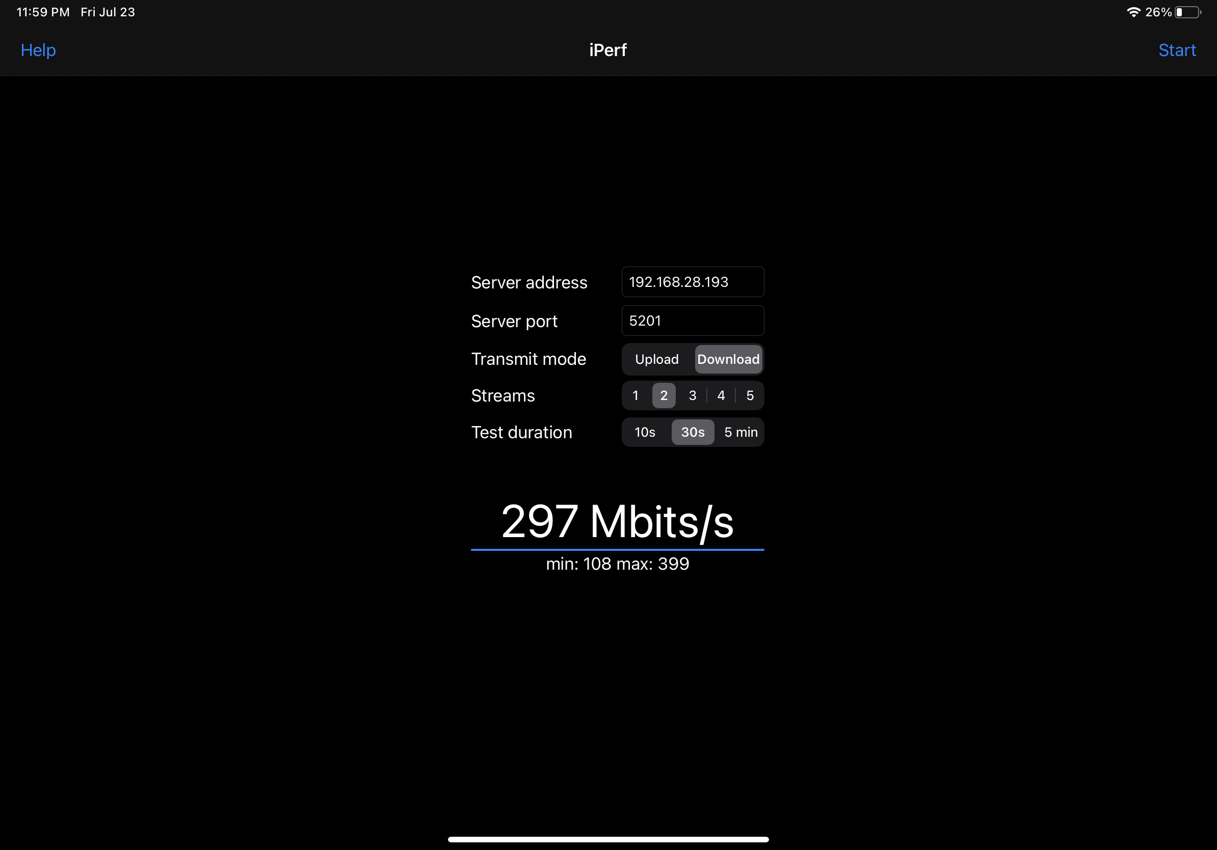

I don’t have a computer to host the iperf server, so I use my phone and ipad.
Speedtest are run on my phone too.
I have the same speeds, so something must be off. Have you tried a proper spectrum analyzer?
