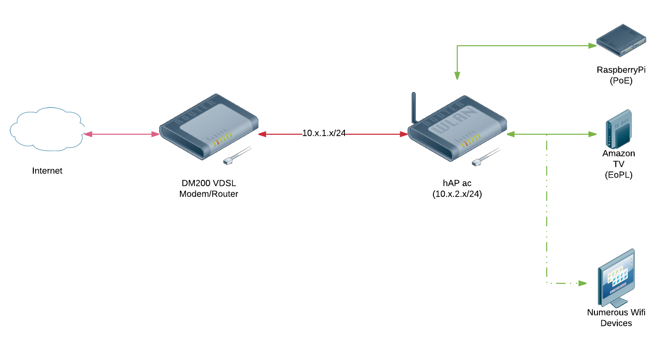

I recently wanted to upgrade my TP-Link Wireless Router that was struggling with the 15 wireless devices that we have in the house, and replace it with a more appropriate combination that could grow and adapt as my family get older.
This weekend, I made the switch to a Netgear DM-200 ADSL/VDSL Modem/Router and a Mikrotik hAP AC. I connected them as follows:
I’ve had real issues with the WiFi connection dropping out on both 2.4Ghz and 5Ghz, even though a scan of the local area shows that the hAP is finding channels that are less busy and auto-configuring the WiFi to listen there.
I’ve also not been able to configure the DM-200 to pass through to the hAP directly, although I believe that this is possible and that the hAP can negotiate the VDSL connection credentials on behalf of the modem.

FWIW, it does seem to be behaving at the moment, however the modem is acting as a router as well, so I have 192.168.x.x/24 connecting the modem to the hAP, then 10.x.x.x/24 connecting all my devices to the hAP
