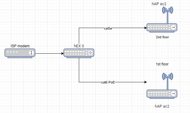

Currently I’m attempting the following setup:
However I’m having problems getting these devices to work together. I’ve attempted multiple different modes for the access points however I’m either having

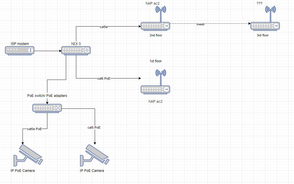

Also in the future I want to connect a third access point which would not be wired (is mesh a good solution for that). Below is a diagram of what I am planning to expand upon and would like some advice if it’s possible with these devices that I have.

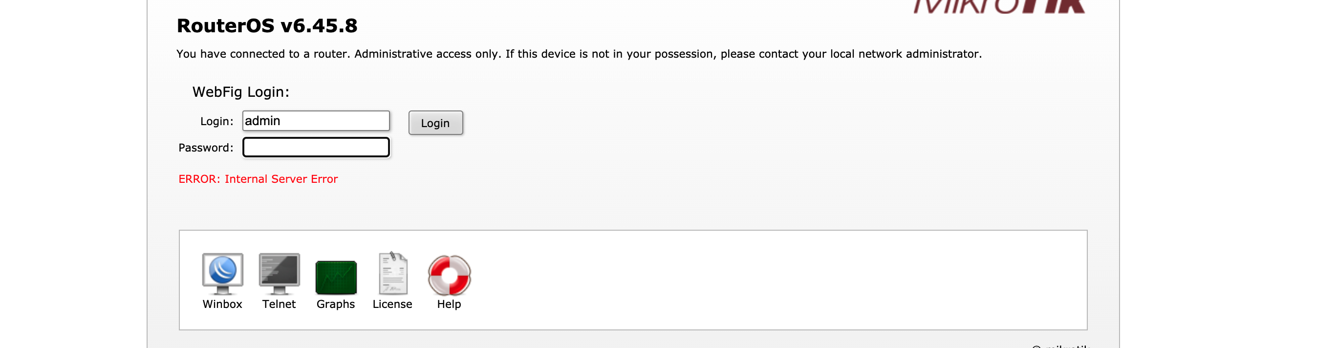

Seemingly it kinda works, however I see that for some reason the network is very unstable. Any devices I have connected at some intervals stop having internet connections even though the wifi wlan network keeps working. I tried to check the configuration on my router but I noticed I keep getting disconnected from the default gateway (192.168.88.1) and I get “Error: internal server error” like so:
Any help to figure out what could be the root of this instability would be appreciated.
