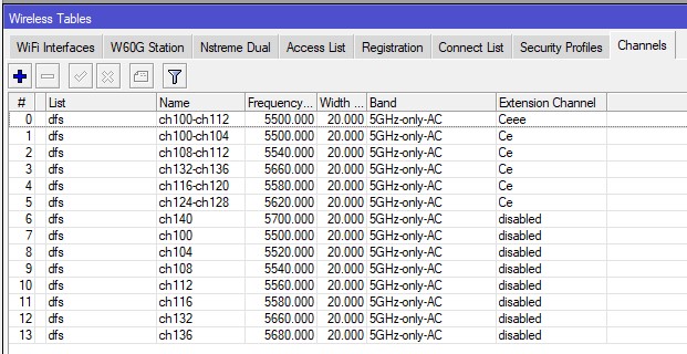

A radar detection may still overrule your own setting. To be somewhat more in control, you have to fill in the “Channels” table.
Something like this … (my values irrelevant for your case). HOW RouterOS is using those tables, I couldn’t find out yet. (Regular start over from the beginning of the list, by radar detect (= false positive mostly))

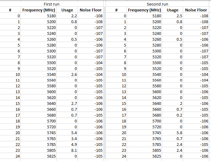

Why then would the 5620 setting yield such poor results? In building the channel table per @bpwl I likely would have chosen that one myself. Here’s a sample of two frequency scans (first on the left, second on the right):

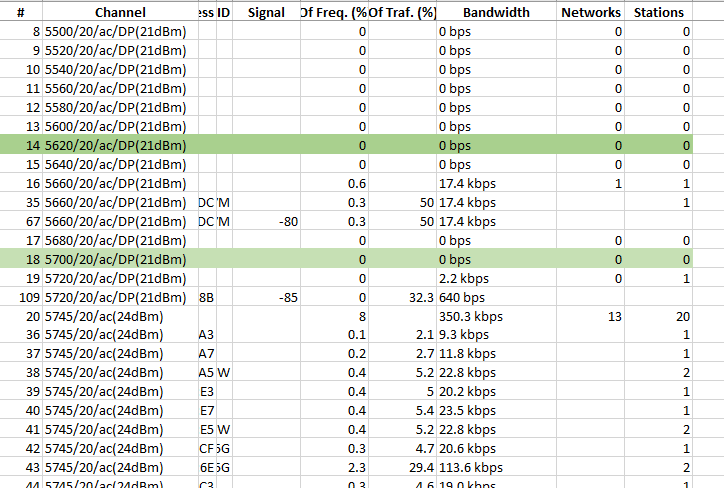

And here’s a sample of the snooper output, sorted by channel:
I don’t see any reason to pick 5700 over 5620, but clearly the end results are wildly different. Unless I’m misinterpreting the freq/snooper data, I get the impression I will have to pursue this empirically, trying all the apparently clear frequencies for performance, then building the channel table accordingly.

@bpwl Could you point me in the right direction to create the Channels table? I tried to “add new,” but the “List” field is required and empty, and I haven’t yet found where to create the Lists that would populate the field. In the screenshot from your earlier post, how did you create the “dfs” list?
