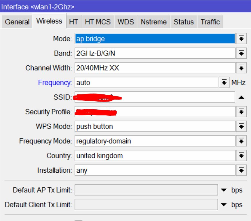

Hi all,
I would need to set channel 11 on my hAP ac3 as someone has set an overlapping wifi on channel 3.
I understand that channel 11 has a centre frequency of 2462 which is not in the drop-down list of my router. I can manually select it and it works but if I check after a few days the router is back to “auto” and it selects channel 6 I think.
Can someone please help me? I am on RouterOS 7.6
Tony

interesting, I see 2462 as 2Ghz interface frequency but the GUI reports “auto”. 5Ghz is intentionally on a separate SSID and hidden.

UInless you live in a place where there are no nearby Wifi networks, you could better not set a 40MHz bandwidth on the 2.4GHz radio. Instead, turn extension channel off.
Besides (though no problem related), configure extension channels manually (i.e. Ceee), otherwise there is no predictable outcome which control channel is used.
And at last…hidden is like…not hidden. It is just not shown by default in wireless clients.

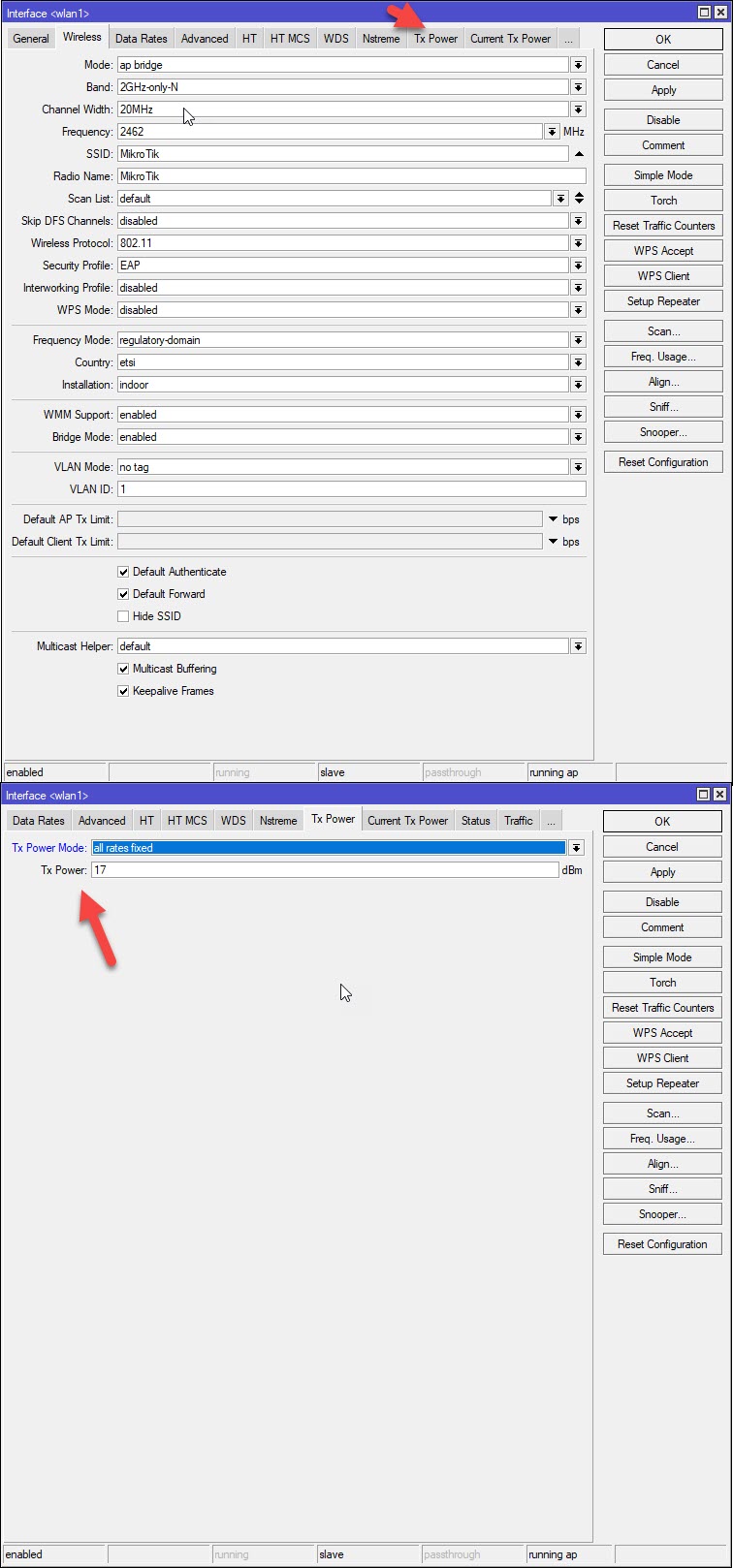

So to switch to 20Mhz width I just select “20Mhz” under “Channel width” and then select channel 11 (2462), is that correct? Any other tweaks you’d recommend? Looking at your previous post, do I “turn extension channel off” when I tell the AP to use 20Mhz width?
Cheers!
Yes, that’s just fine.
My recommendations
  • You can turn off WPS Mode (from a security perspective).
  • Don’t use 802.11a/b unless absolutely necessary
  • Set WWM on (advanced settings)
  • Optimize Rx Power (advanced settings)

Thank you both! is 17dBm the maximum? I assume this way we prevent the AP from changing things around.

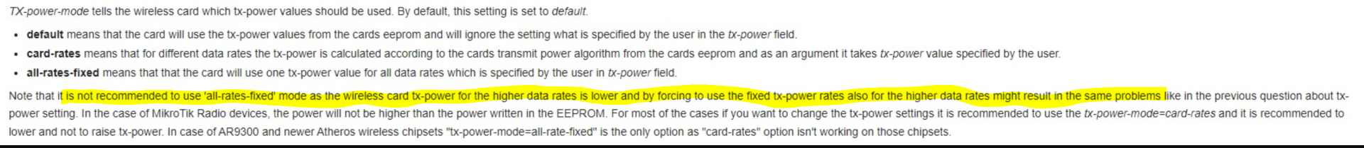

I was reviewing the thread and I would like to double check the “optimise TX power” subject. I see Mikrotik does NOT recommend to set “all rates fixed” but the above screenshot is set that way.
Can I please check with you what is the best setting for a reliable signal?
Thanks so far!
For the screenshot, I put it to all rates fixed so it could enable the value.

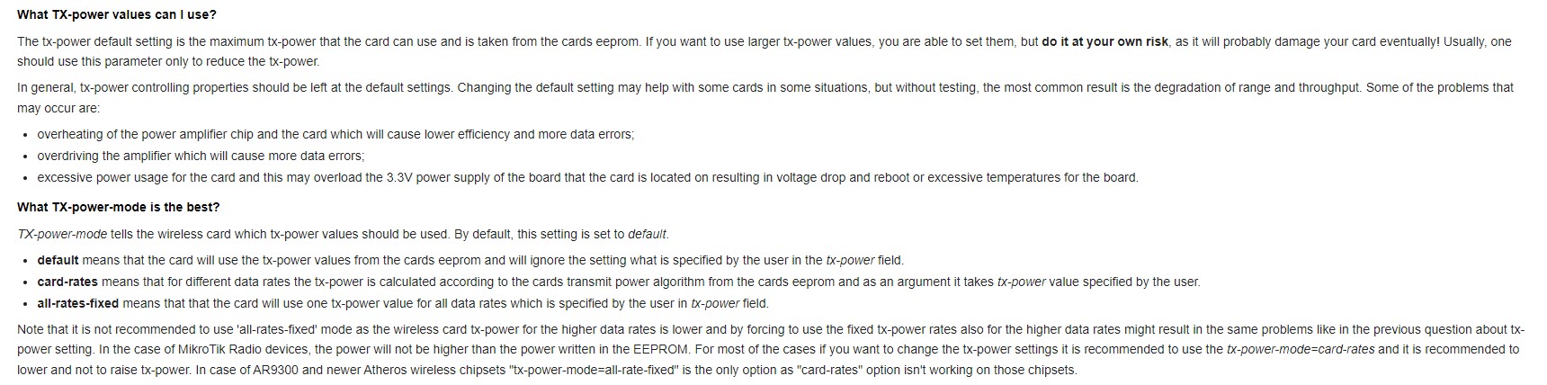

Thanks. I understand that you need to enable “all rates fixed” to enable the value field but I am referring to this:
It looks like Mikrotik is explicitly not recommending that setting. What is your thought on that?

When you want to set “all rates fixed” you should set a lower Tx power than the maximum.
Look what powers it sets when you use “default” (automatic power selection depending on country, antenna, and rate) and set a Tx power lower or equal than the lowest power you find there (in the first column).
E.g. when the max power is 17dBm that would be 14dBm or lower.
