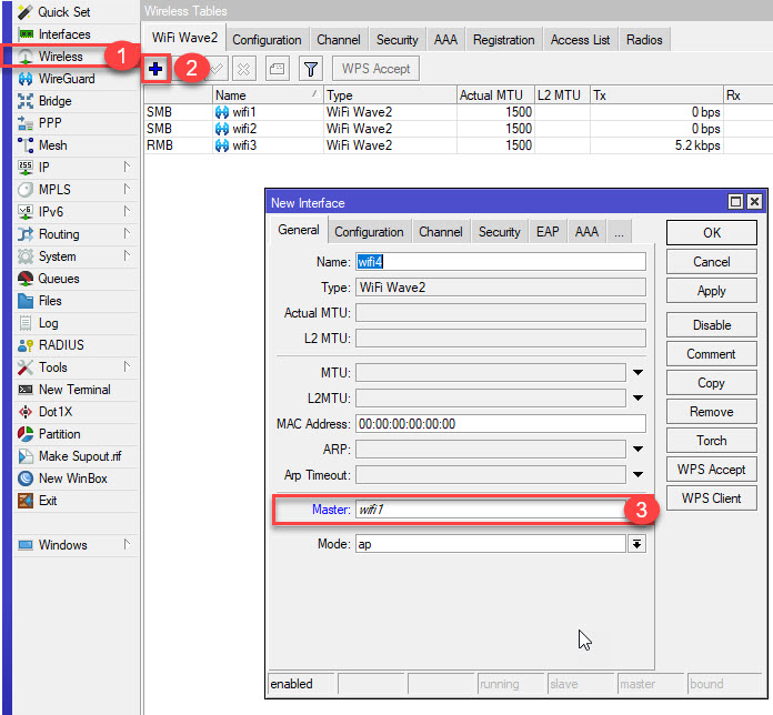

WiFi Wave2 and Virtual-Interfaces
It is still posible to create Virtual interfaces (see Attachement)
Don`t forget so assign the “master” interface.

Virtual access point will become a wifi interface.
From there it is an interface just like any other.
