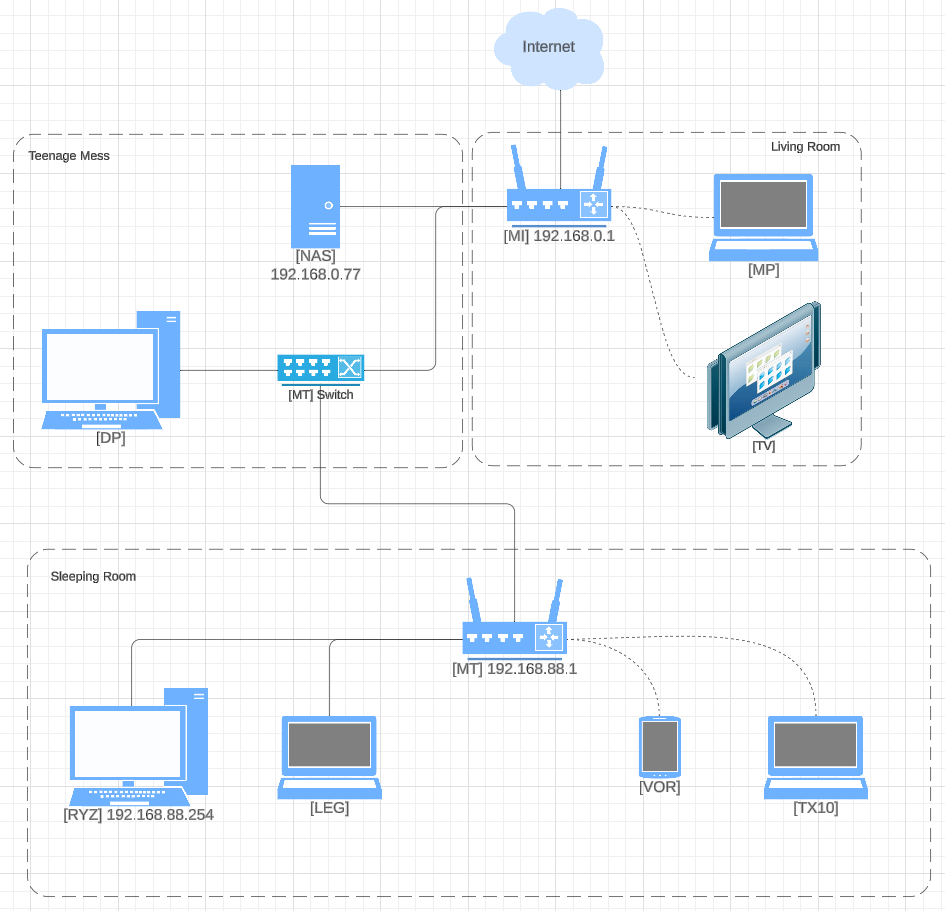

My name is Wojtek and I am doing my best to manage my private network :slight_smile:
I have just upgraded my mikrotik switch to the hAP ax^3 [MT] 192.168.88.1 router to extend coverage of the WiFi in my “sleeping room”.
Everything went well but for some reason I have lost ability to map drives on [RYZ] 192.168.88.254 from 2 samba shares on [NAS] 192.168.0.77.
I am able to open the address 192.168.0.77 in my browser.
I am open to any support :slight_smile:

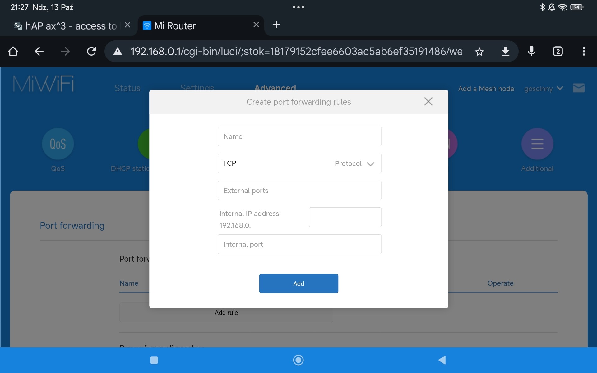

I think in the firewall of the 192.168.0.1 you need a forward rule to allow 192.168.88.0/24 to the NAS.

Would you please guide me through the process? Is below option the proper one on the router?
I must admit that I have no inkling how to do it…

In response to your question - why two routers? It’s pretty simple - I had them in the shack, I needed two locations covered with Wi-Fi and third one - I must admit that I already managed of how to limit internet access to my teenager son in case he misbehave. Fortunately the first router has this option quite easy to configure.

For simple setups, there Is only one device that acts as router, this Is either the ISP modem/router or - if that device Is used only essentially as modem/adapter, the first device behind It, vital as firewall.
This device Is the border between WAN (outside, here be lions) and LAN (inside, home).
Everything below Is (should be) - conceptually - on a same subnet, i.e. all connections should be switched, not routed.
Of course there can be reasons why one would want to run two (or more) separate networks and route between them, but if there are no such reasons (like It seems specifically in your case) It Is only a complication.
You replaced a switch with a router, but since this new device Is a highly configurable one, all you need to do Is configuring it as switch and have only one network, the “main” 192.168.0.0/24, that allows for 254 devices, which should be enough for a home, every device can see and connect to every other one, as simple as It can be.
