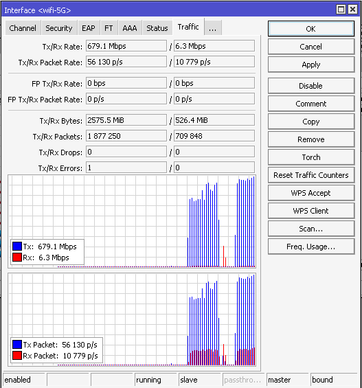

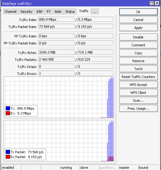

I have a hAP ax2 router from today and I am a bit disappointed. I have a UPC 750/200 Mbit link and on the UPC router I get speeds of about 500 Mbit / s over Wi-Fi 5. I connected the ax2 router to it and configured it for Wi-Fi 6. On the iPhone 13 speedtest I only have about 250 Mbit / s.
I also tested some time ago on ASUS XD6 and I had about 700 Mbit / s after Wi-Fi 6.
Is something wrongly positioned?
Please help.
Configuration in attachment.
I’m getting 750+Mbps on mine. Hard to say what is wrong, it can be a lot of different things, like channel utilization, noise and etc.
From the image that you posted, the device selected seems to not be on WiFi6 rates, but, on WiFi5 ones(720Mbps).
To be able to help, we need to see your full config, in text form.

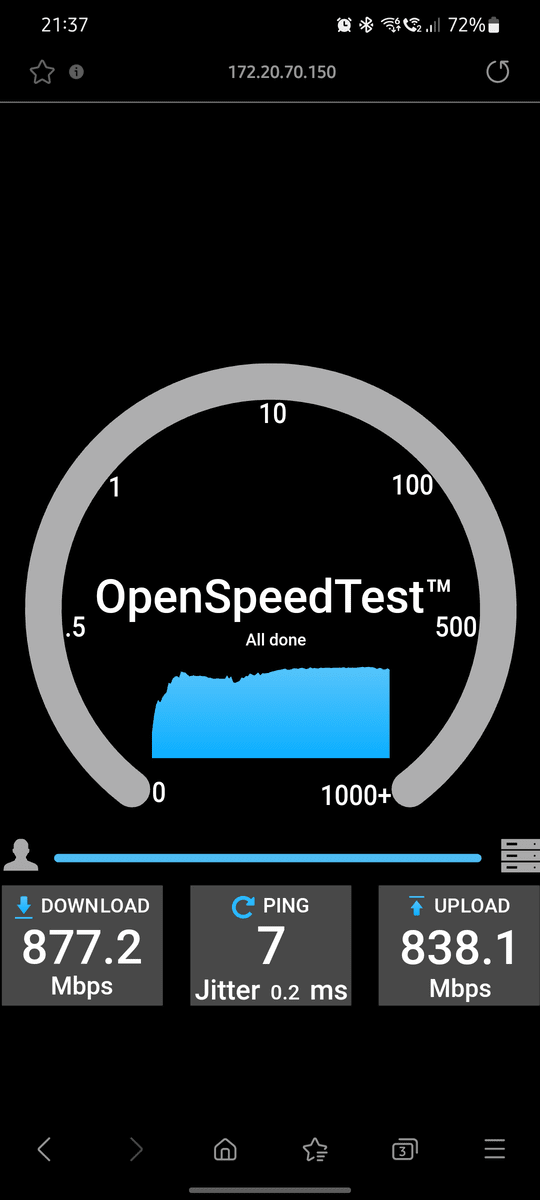

You don´t need 160Mhz to get more than 500Mbps as you can see below:
I’m about 3-4 meters from router.
In the same room.

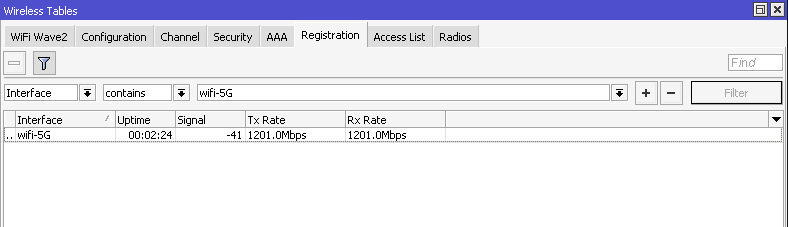

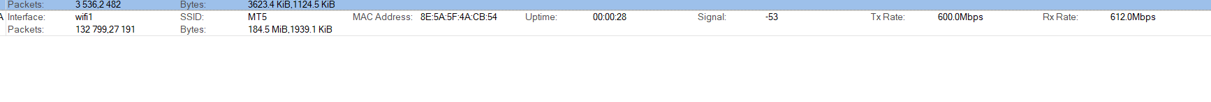

When I start doing speedtest, the tx rate drops to 600/600, not 1201 Mbps.
