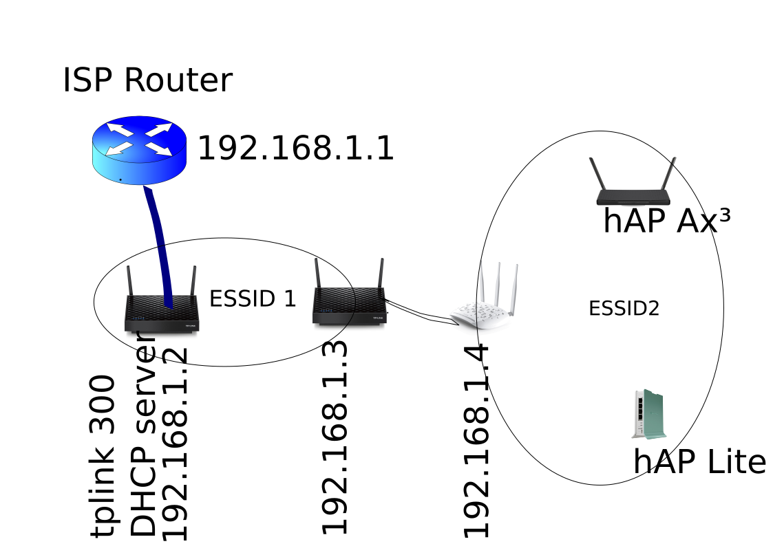

I have a long/strange network between two house (I share network with my parents), more o lest is like (router from ISP connected by long cable to AP, this AP connected by wifi 5Gh to another AP in mode station, this AP connected by long cable to another AP, and at this last AP is where I connect my Mikrotik Hardware):
Router (ISP)------AP:Tp-Link AP300–)))) ((((–AP station: TP Link AP300-------------AP: TP Link WA901ND —))))) (((((–Mikrotik or other PCs/devices
DHCP server is at fisrt TP Link AP300 because is bettter than DHCP from the ISP Router

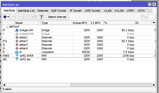

Well, first of all I buy a hAP ax³, and configure de wifi 2G as station of the last AP. All correct, it takes de Address, and masquerade the output,.

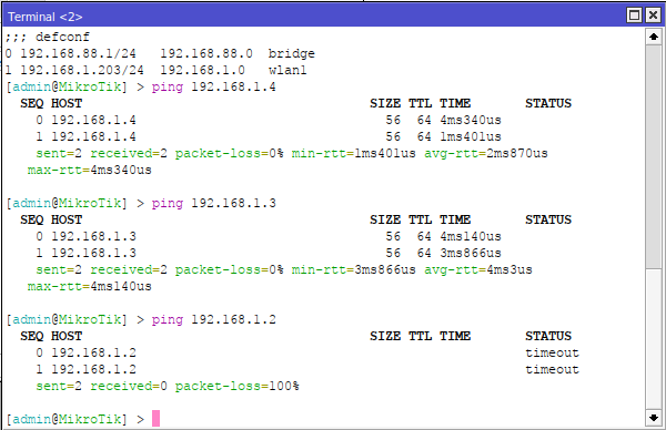

  • If I put static IP on mikrotik I can ping to the last AP (192.168.1.3) and to the second (192.168.1.2) but it can’t ping to the other part of lan (don’t cross de wifi connection). But at the same time de ax³ it’s working correct, and other devices connected directly to the last AP can’t go to internet too.

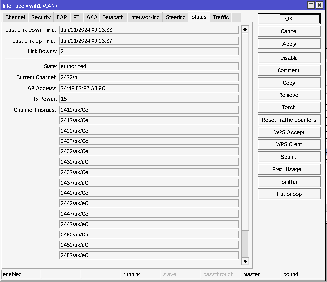

The interface “wifi-WAN” have identical configuration on ax³ and on Lite (very basic, mode station, in any bridge, DHCP Client…)

I would like to see a graphical network diagram. It’s very difficult to understand otherwise. Also, show your configuration

this is more or lest a topology schema
DHCP pool is between 192.168.1.200 and 192.168.1.240 and is “empty”. The Ac^3 is taken 192.168.1.201.

They connect to TP_LINK_A39C_2 that have MAC Filtering enabled and properly configured.
I also try to configure de Lite connecting directly to the first AP (who have de DHCP server) and here it takes IP and have connection to internet.
I think that the problem is on wifi link between the to TP LINK 300, but I don’t understand why Lite is the only device who have problems, and why this problem…

I installed a new wAP AC (upgraded to 7.15 and with wireless package) and it do like Lite (no DHCP Client, and with static IP it can’t ping 192.168.1.2)

but looking at your topology it does seem that it’s something in your TPlink network preventing your RBs to reach default gateway … 192.168.1.x are supposed to be in same L2 network, so ping should “just work”. Since you can reach .4 (the AP which wAP ac is connecting to) and .3 (the AP beyond .4), it doesn’t seem to be the issue in ROS config … to this point. The route snippet above only comes into play after you’re able to reach 192.168.1.1.

I already removed wlan1 from bridge (without I can not set DHCP client on wlan1), but is true that wlan1 wasn’t on WAN Interface List. Despite I can not go to internet, and NAT does’nt couldn’t do his job properly, I supose that from mikrotik terminal I should ping to all 192.168.1.x network. I think similar, It’s strange, but it seams a L2 problem between TP Link AP300, not ROS problem.
