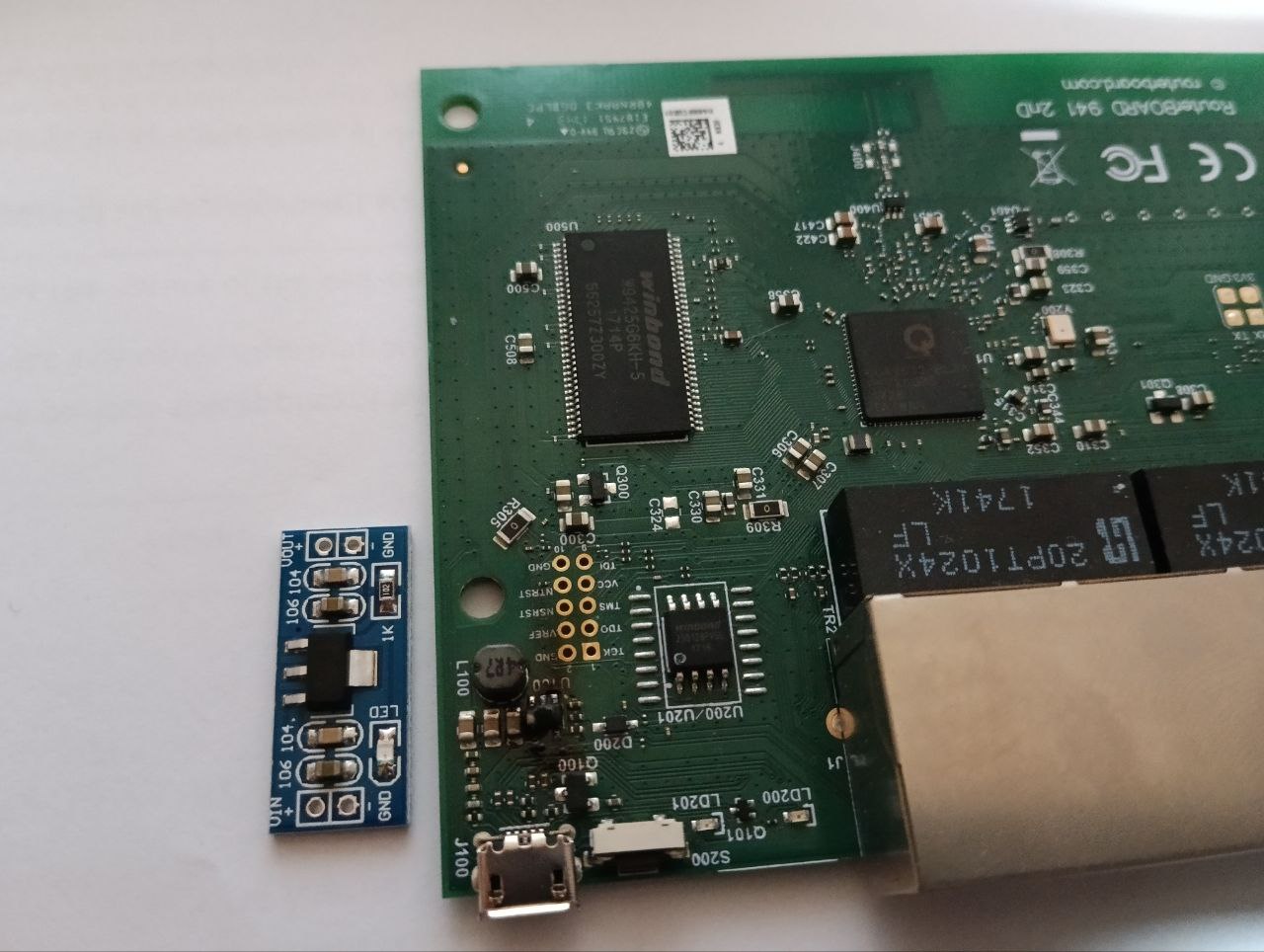

It is very bad that the devices have a very narrow power range, unlike other devices Mikrotik.
The photo shows the Hap Lite after the 12 V supply.
Installing this module instead of the burnt out one allows you to change the power range to max 15V

How you provide 12V to a device that work by USB @ 5V???
And this is the old hAP n lite, nothing to do with hAP ax lite…
It wasn’t me, they brought it in for repair.
But this case is quite common. https://www.youtube.com/watch?v=zF2zbfIyOEs

USB-C port is for power ONLY on hAP ax Lite.
I imagine this module is not for free? Is the added cost really worth it, instead of educating user to use included power adapter ?
But module in this picture is linear regulator ? Why not switching regulator ? They are not much more expensive than this module.
Voltage diference will be burned in regulator, so if you need 5V and 500 mA, that’s 2.5W for router, but if you have 15V at 500 mA then that is 7.5W at the input side, you are burning 5W in this SOT package. That’s a lot of wasted power… And heat in this small regulator…
Mikrotik have switching regulators, so they are more efficient and in this picture input is 5V USB so there is no need to have wide input range and probably this regulator is much more efficient. Mikrotik’s with barrel jacks have wide input range switching regulators for the same reason.
In our country right now there is a shortage of everything that relates to alternative power supply, you have to use what is available. Of course it is better to use a DC-DC converter.
