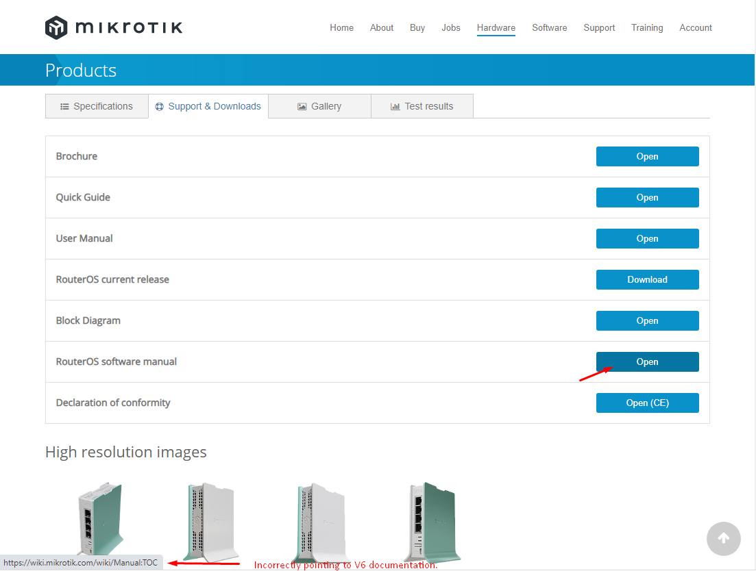

@normis Can you have someone fix the link in the hap ax lite product page that is pointing to v6 RouterOS documentation?
hAP ax lite RoouterOS software manual link pointing to wrong documentation.png
