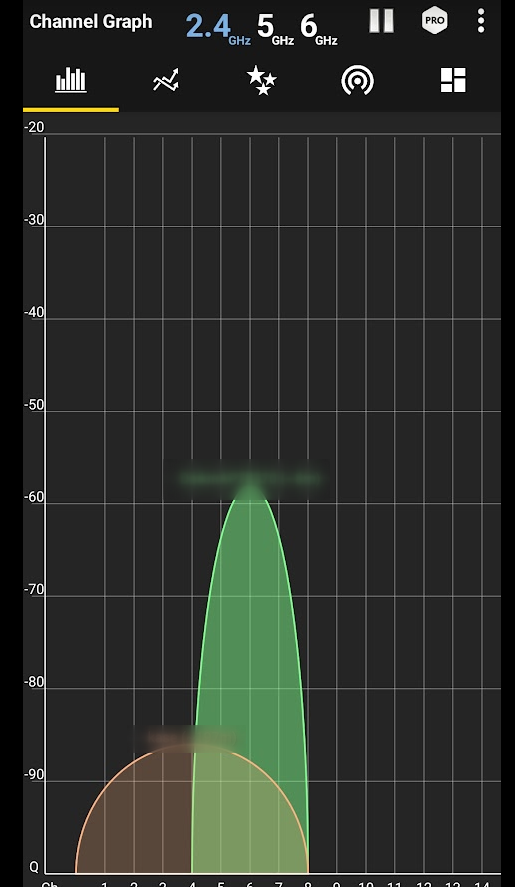

I am also looking at 2.4ghz channels. I am using “WiFi analyzer app” which tells me that my neighbours wifi is using bands 4 to 8. Should I use 20/40MHz channel width for optimal performance?

I found out that the other 2.4gHz network is actually the management WiFi of a Daikin A/C my grandparents have. I have steered clear of that range manually for now. Also because it is a rural area I am going to try to change the WiFi regulations options to not be my country - maybe I can crank the settings that way. As the nearest neighbors are a good distance away.
