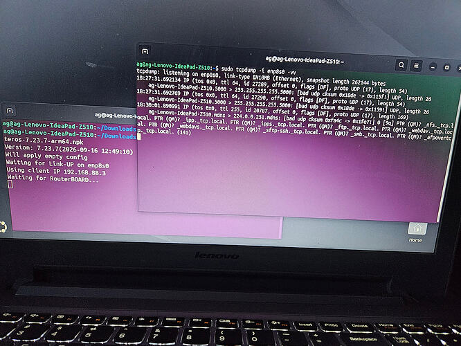

I haven't tried using Linux. I'll give it a try and let you know.
On Linux also nothing...
