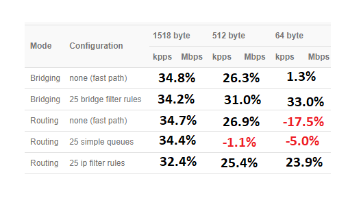

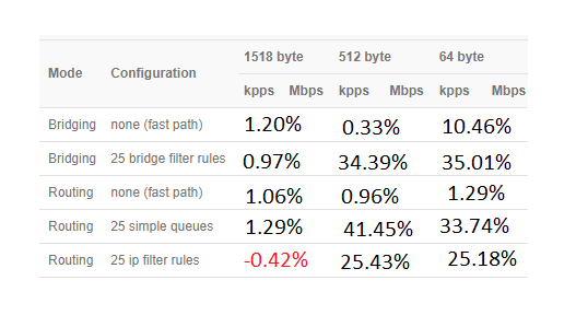

Let’s accompany this with some crude calculations
% of advantage of ax3 over ax2
where you see single digit advantage is because is reaching CPU to SWITCH interface limit not cpu processing limit
