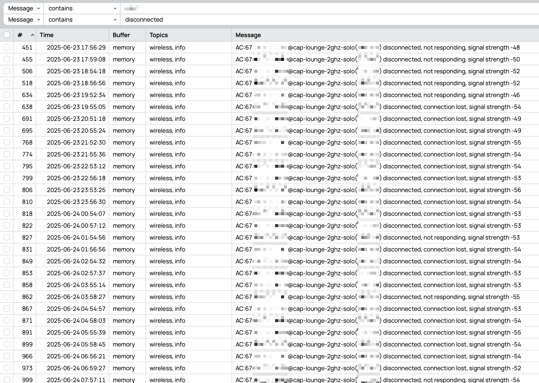

updated AX2 to 7.19.2, problems with disconnecting WiFi are gone, that’s good
but some of my home devices still can’t work with WiFi AX2
  • mercusys mw150us, 2.4Ghz - ping 100-200 speed less than 1.5-3 Mbps
  • huawei matebook d15, 5Ghz - ping 100-200
the most annoying thing is that TP-Link AX3000, which is three times cheaper, works perfectly.
OK, so been running 7.19.2 on my 2x hAP ax2 devices running on capsman for about 3 days now - rock solid without my Google Nest Hub connected.
Last night I turned my Google Nest Hub on again - it still disconnects a lot though :frowning: Strange though - it disconnects twice at the end of every hour. Fortunately, it doesn’t cause the other devices on my network to disconnect anymore :slight_smile: Nonetheless, when I use an AC device instead of AX, then it works fine without disconnecting so much.
Does someone here have a Google Nest Hub (2nd gen)? If so, can you please see if you can reproduce this?
I administer a hotel with RB5009+6 cAP AX. The latest patch did not fix anything. There are still many disconnections.
The Wi-Fi operating conditions are difficult, thick reinforced concrete walls. But it disconnects users even with a 50 dBa signal.
Iphone and some Androids often disconnect.
In vain did I advise buying Mikrotik.
I do not have these nest hub devices which apparently caused extreme problems by even disconnecting other devices from AP. But I had some infrequent disconnects because of “signal greater than <insert number 50-160 here” (remark: positive number) and frequent disconnects of some devices that try to roam from e.g. wifi1 to wifi2; signal lost log message, right after connect to wifi2 again. All in a loop for 10 seconds and then staying connected. And the worst of all: only a single device in my whole network, a AX200 Linux machine, is unable to connect to 2ghz wireless. There are plenty other devices happily connecting to 2ghz and even some perfectly roaming. But this particular AX200 can’t connect to 2ghz, journal says as reason something like “AP full. AP refused to connect”. But why? It somewhen started after some 6.x Linux Kernel version. Seems like I have to go debugging again. Last time I reported an update for my support issue (maybe 2 months ago) the response was like “we are already working on a solution together with Qualcomm”. Great, I thought. But changes in 7.19.2 don’t seem to be the all-in-one fix for every wifi-qcom wireless issue.
Did you create a ticket with Mikrotik support???
