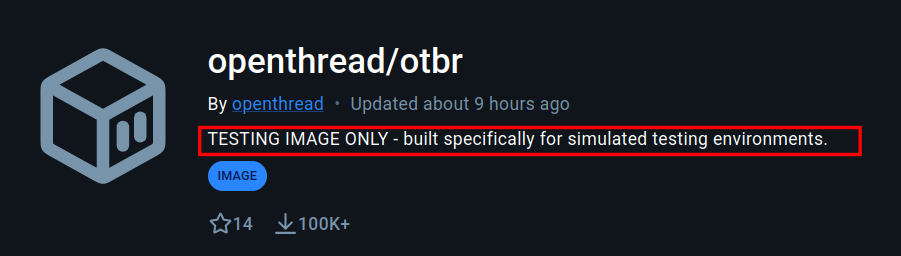

This image is built specifically for continuous integration (CI/CD) and simulated testing environments. It is not intended or optimized for real-world or production use.
For production deployments, please use openthread/border-router.
Why does ROS use "otbr" then?
Indeed. The router is indeed an excellent "all-in-one" machine for me.
