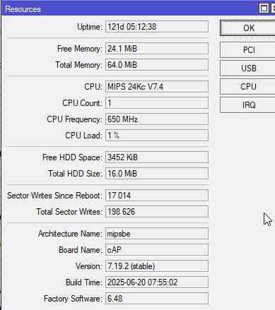

isn't that more directed to arm devices having 16Mb ánd using wifi-qcom-ac package ?
With wireless I don't see much space constraints (yet) on those 16Mb devices.
Example cap
