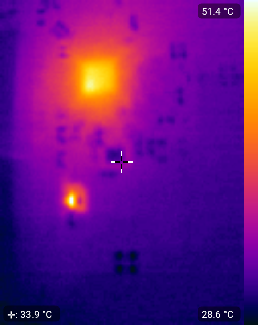

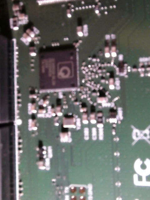

Siriusly, what evil snape is biting this AP? Why is it better after an overnight power off break and worse when I retry right again?If it is not software, then it may be something temperature related … so let’s open the hAP and find inside, besides lots of air, a thin PCB. Thermal camera on, first pic, press F5 on 192.168.88.1, second pic.
There is one component which is getting hot. IR camera says 50 °C when I get close, which is by far not close to typical limits of electronical components, but as the part is rather small, the camera may well be off and it could be that this part is heating up to 100 °C and more. It is Q301, so some kind of transistor, which is also bad because a hot transistor means a lot of current that flows.
So this might be the reason, only Mikrotik could confirm though as this requires knowledge of the circuit (or at least more knowledge than I have).

@granjow thank you for the photos, the only other close ups of the board are on the Openwrt wiki.
Just out of interest, why would they be helpful? :smiley:
(The ones you mentioned are of better quality than those of the IR built-in camera too)
