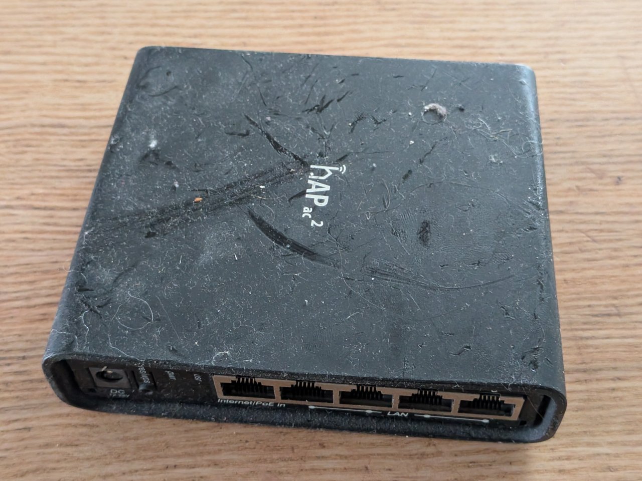

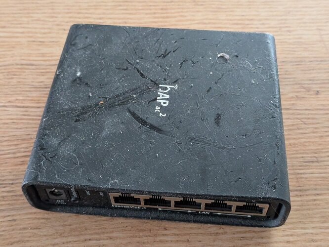

hAP2 Turned to Goo
Anybody had their hAP2 soft outside turn to goo on them? You can easily leave your finger prints in it and whatnot. I ended up covering it with plastic so it doesn’t stick to my hands.
What is the environment?
Any oils or plasticizers come in contact with it?
Or soft plastics in contact with it?
Or “china” rubber (the kind that stinks, that cheap car floormats are made from. If you have ever been in a Harbor Freight store, you will know the smell).
It was just sitting in my house not in contact with anything. The humidity would have been higher but that’s about it.
No, never…
Not feeling sticky at all.
Old thread, but I too have this problem. It's clearly due to manufacturing defect - incompatible coating was used and it has degraded severely. I hate it so much when manufacturers paint over plastic...
I'd love it if Mikrotik would acknowledge this problem and send me a replacement enclosure.
removed the stick rubber of ac2 by using ethanol with kitchen metal sponge.
