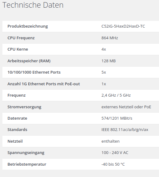

it is advertised that the hAPax2 has 1GB RAM and 128MB storage size.
But some online shops say it has only 128MB RAM. This is confusing.
Are there really such different models of this hAPax2, or is rather the info at some shops/distributors simply incorrect?
Here’s an example of an online shop (in German, see the row “Arbeitsspeicher (RAM) : 128 MB”):

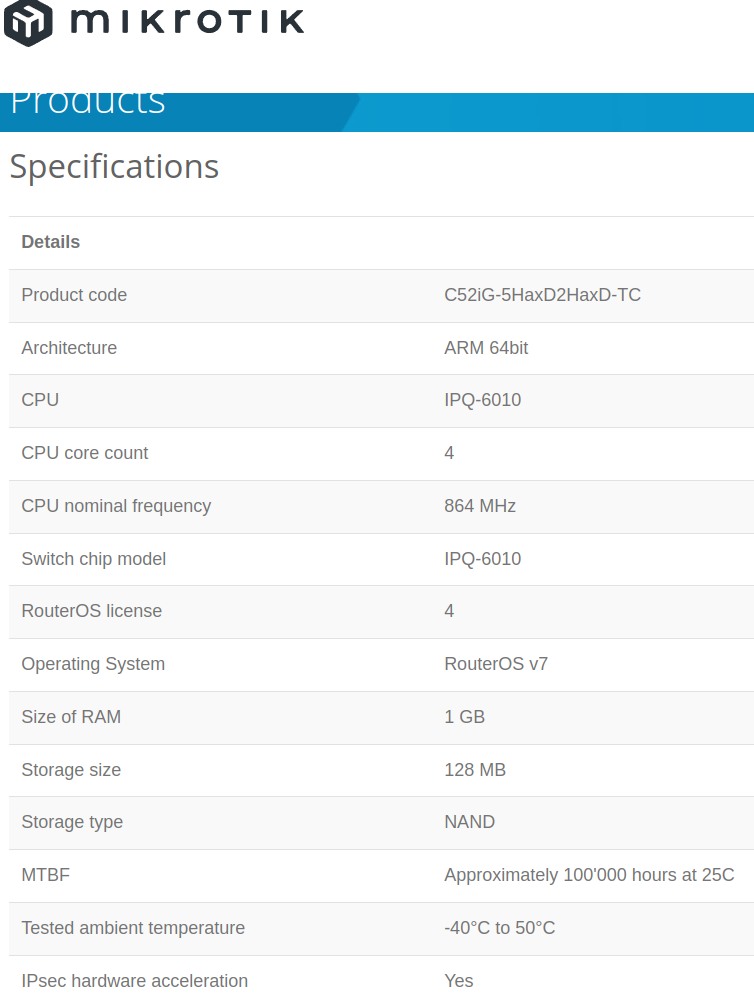

Compare the above data to the info here at MikroTik:
https://mikrotik.com/product/hap_ax2
Online shops have wrong information. There is only one version with Storage 128MB and 1GB RAM.
Or difference between storage size vs ram got lost in translation …
Always revert to original product pages in case of doubt.
