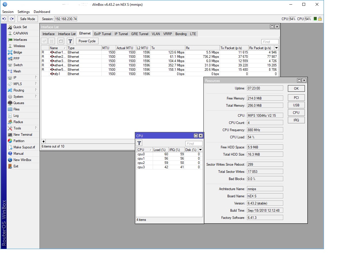

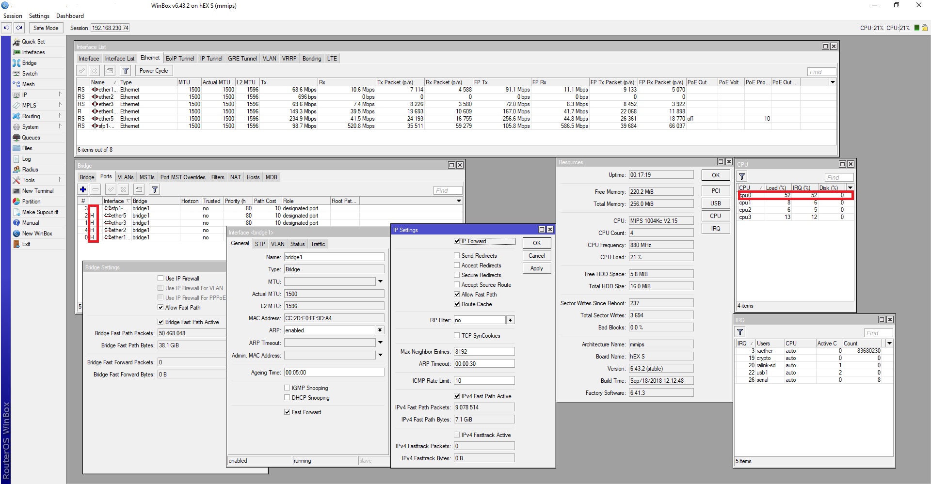

Dear Mikrotik team. In mikrotik heX S board, when the router is working, the total percentage of the processor shows 20%, but when I look at the system resource cpu index, it shows that the first processor is loaded by 80% and the rest of the processors are loaded by 15%. The reason for this is that the SFP port does not support the Hardware offload, it loads a separate CPU and it is not part of the switch. Therefore, it will not be possible to use the router if all traffic goes through sfp.

the numbers you write do not correspond with the picture
you say one cpu at 80% picture shows 55%
you say other cpu at 15% picture shows 8, 6 and 13%
please show tools profile to see the source of your cpu usage
thank you. already sent
Thank you for the answer. It’s a good diagram, but I want to know why in the system resources show separately from system resource cpu?

The values are changed for every second. In screenshot moment it was with that values. It doesent mean that I am lying. Thank you.
I don’t really get, what you mean.
On your screenshot:
In CPU you have the load: 52% + 6% + 8% + 13% = 79% out of 400%
That’s 19,75% of the whole CPU
In system resources you have 21% for CPU load.
19,75% and 21% (rounded) are pretty close :slight_smile:
Why the numbers are not equal?
You told it yourself: the load is constantly changing, and may be number in system resources is derived from some previous readings, or average for 1-2-5 seconds.
Anyway, you push over 600Mbit through the CPU and it’s only around 20%
So if you scale, I guess it will be first bottlenecked not by CPU, but by the 2Gbit aggregated lanes from the CPU to the ports.

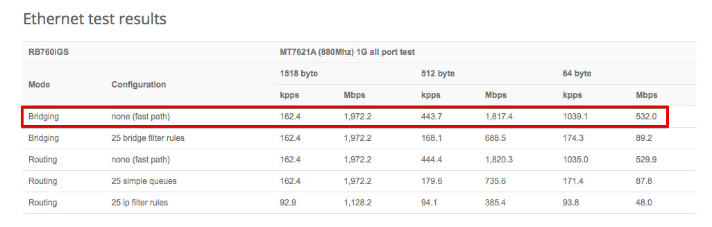

And it corresponds quite well to the official test results:

If I look at the CPU usage I could reach 2Gbit/s if the CPU is maxed.
