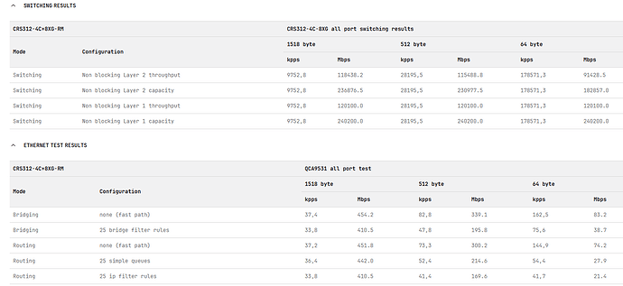

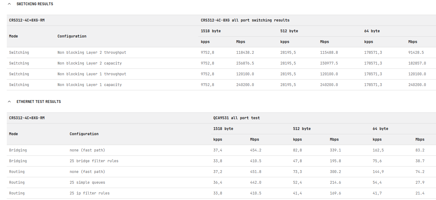

You must be doing something that is preventing the CRS from offloading the switching to the switch chip, because the CRS block diagram has a 12 port non-blocking wire-speed switch build in to handle the L2 switching functions in dedicated hardware.
So something in the config is causing the switching function to be done by the software bridge, and the CPU in the CRS312 is meant for management functions only. And it won't be able to route or bridge in software with the performance you need. Compare the switching vs ethernet (CPU software based) performance numbers.
