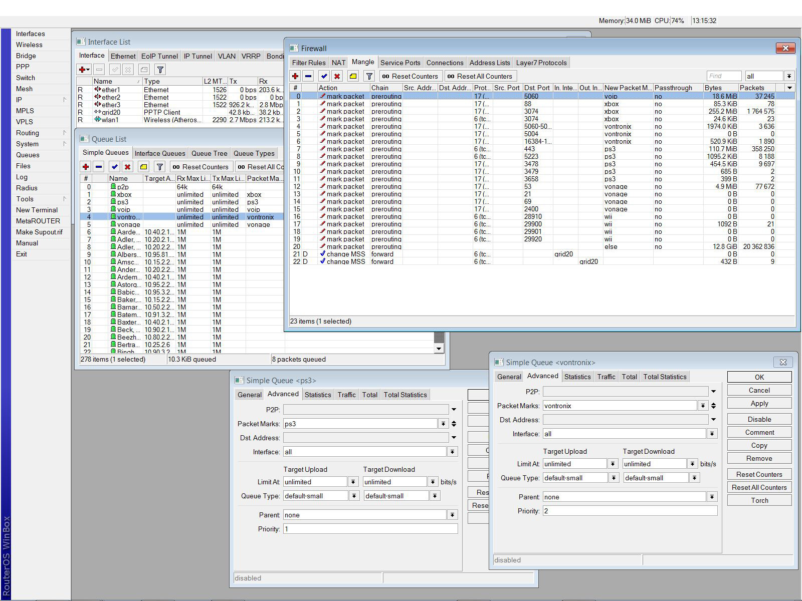

I have been trying to get some traffic prioritization setup and have been having some problems. Ideally I would like to set up the prioritization on the same router as the PCQ/QOS setup that Janis covered in his video. I am testing this in the office and have the limits choked down quite a bit to make sure I can saturate the ques.
The problem I am having is it seems that my packets are correctly getting marked but I think I have something messed up in my que structure because when I put the router with the priority inline and ahead of our existing router that is doing customer ques it doesn’t seem to be queing the traffic correctly. For example http download que will never max out even if none of the other ques are being used, also pings which are marked and put into a the highest priority que will time out even when the parent que is far from being saturated. Anyway here are my mangle rules and que tree that I am using. If anyone could help me out here it would be appreciated.

I finally figured out the problem after beating my head on the wall on the config. It was an Ethernet port mismatch issue between the 450G that I set up the Prioritization on and our cisco router, I locked down the port and it works like a charm.
