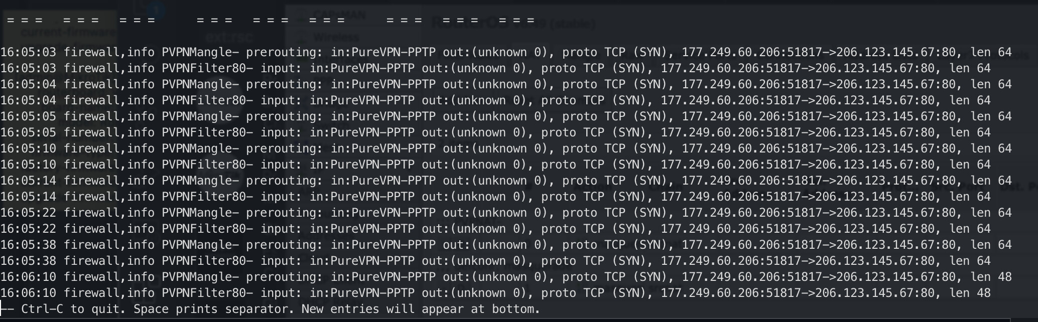

Can you Post a Screenshot of the LOG?
Sure, I just attched it. This log is the result of a tcping to the external, static IP of the VPN 206.123.145.67 on port 80
I don’t see NAT entries in the log and in all counters for the interface there are only packets coming in, nothing coming out

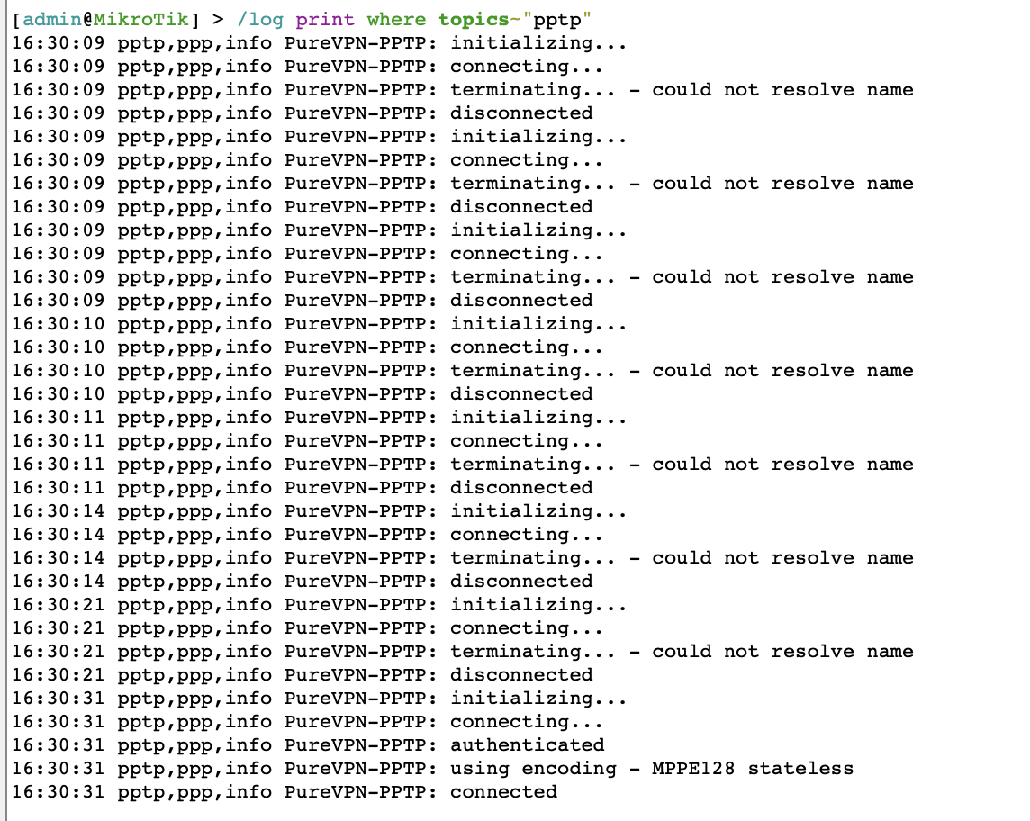

Reboot the router and screenshot of LOG with filter !
/log print where topics~"pptp"
Sure please find it attached
Thanks a lot
Could not resolve name indicates a DNS-Problem
We will have to find why…
But for now try the IP (192.253.246.2) and see what appends !

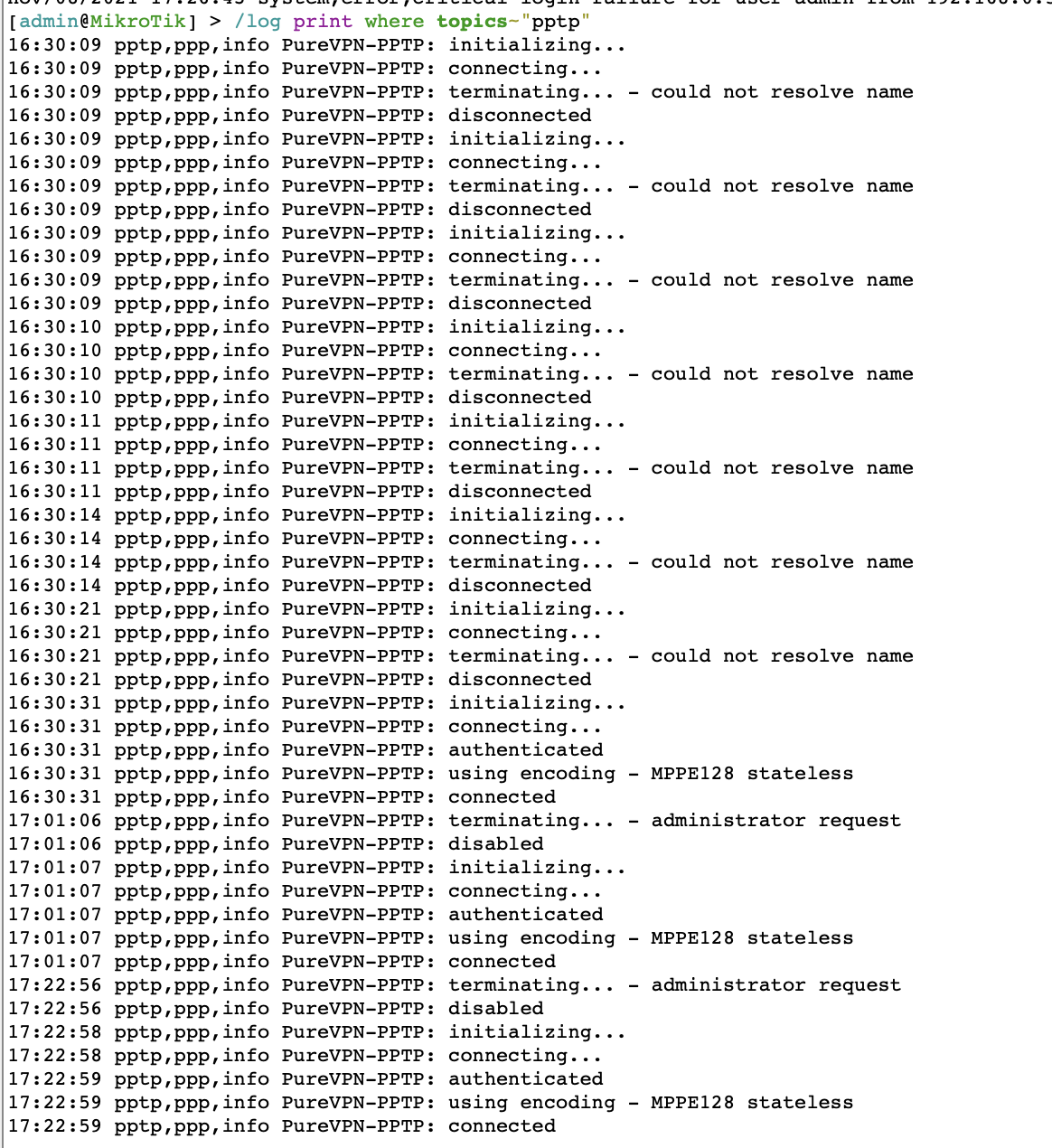

And Post screenshot of LOG (/log print where topics~“pptp”)
Sure I disabled everything in the firewall and disabled-re-enabled the PPTP interface
Ok— So DNS is not the Problem..
Next Error → MPPE128 stateless
I looked it up in the Forum:
You may need to edit the PPP Profil and try again

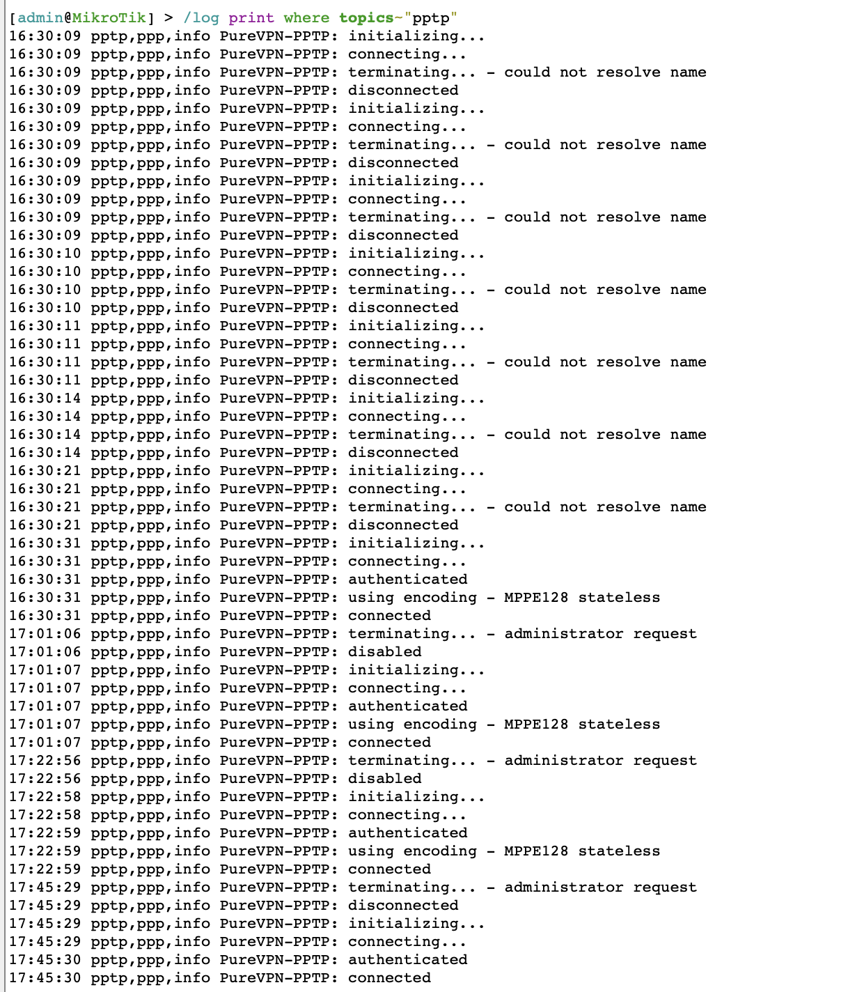

Thank you for your help, I changed the profile in the PPP interface from “default-encryption” to “default” and the “MPPE128 stateless” message is not showing anymore, but the problem persists, re-enabled the firewall rules and still can’t access port 80 from PPTP interface. I’m including the log of the interface restart.
You won the First Fight =)
Log showes the VPN is working !
“PureVPN-PPTP: authenticated”
“PureVPN-PPTP: connected”
