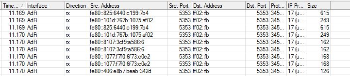

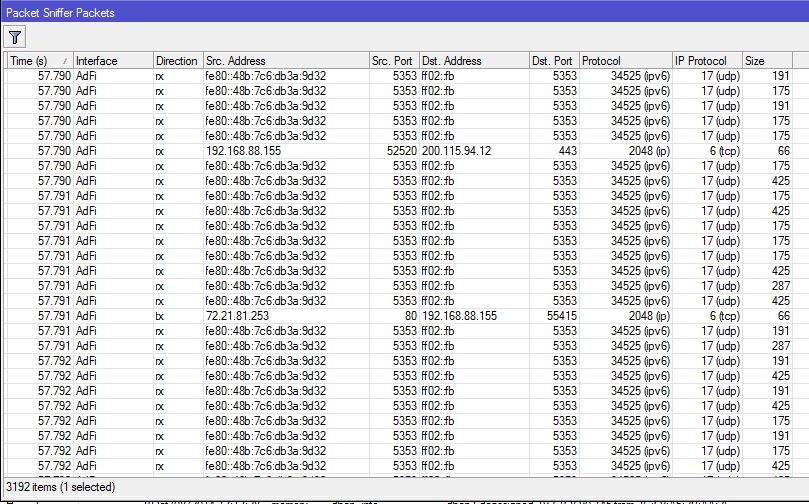

This is what I get using the Packet Sniffer:
I guess this is the responsible for the alert and the problem, right? Should I just block the Dst. Port 5353? I think it wasn’t enough when I tried… help?

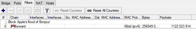

I think I found a solution but not sure if it’s the best…
I created a filter in the Bridge for the MAC Protocol (ipv6) used by all these iOS devices creating the flood:
The amount of packages are crazy and they are using a lot of CPU.
Any better solution?

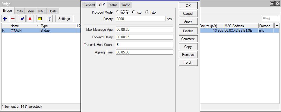

I cant find RSTP on your bridge, but it could be another issue that you have…
My guess is that your client is using multiple apple products to stream music or video in your wifi network. Have you tried blocking communication between clients?
Yes, i do have RSTP enabled in the bridge:
About the communication, I don’t think they are internal communications between clients but multicast performed by different iOS devices:
As you can see, I have different source addresses sending such packages.
Btw, the bridge filter blocked already more than 217 millions of packages in the last hours! it’s crazy!

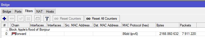

Take a look how many packages were already blocked since yesterday:
The good part is that everyone is using internet without problem in the hotel but I think is crazy to keep blocking it that way.

As you can see from sniffer you are receiving the same packet multiple times, so it is definitely a loop in your network.
and how can I detect where is the loop?
