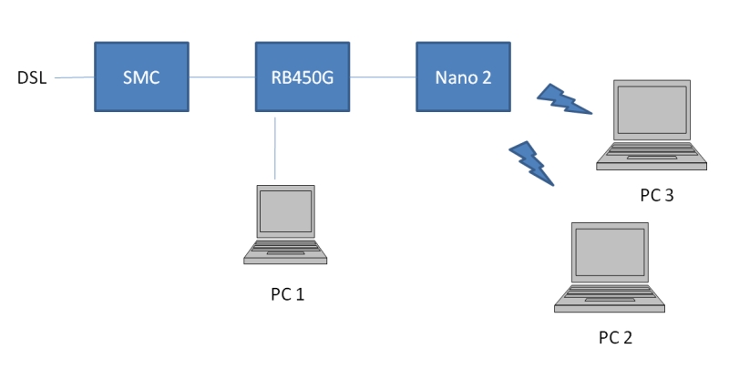

Could you make a small drawing on how you want to connect your hardware. Something simple like this. Then we can go through it step by step.

OMG Pilgrim looking at what you have would be fine with pc or laptop at my end.
then nano wierless out from there great for home and see how far the bullet2 and and omni antenna will reach my brothers place from me.
So yes what you did in your picture would be just fine to get working after I see it working will help me understand things better.

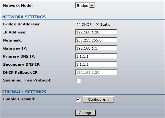

And at this point to log into nanostation and bullet they have the same ip as 192.168.1.20

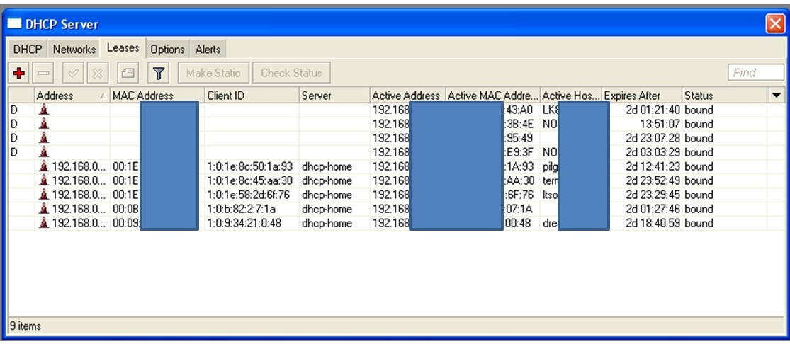

I don’t have any experience with the nanostation, nor the bullet. But the unit you connect to your RB450 as AP should be in AP-Brigde mode - or similar. Be sure that they are connected with an IP belonging to your LAN. Ideally as DHCP clients and then make a IP reservation in your mikrotik to ensure that the unit will always have the same IP.
Those marked with D are dynamic and the rest are fixed.

I have no experience with Bullet and / Nanostation, but both are from Ubquiti and seem to be using the same firmware “AirOS”
The setting you mentioned seems to be the default setting. There is a pretty good resource here.
http://wiki.ubnt.com/wiki/index.php/Image:25a-Network-Bridge.png
You can use the static setup mode, but then you should choose an IP outside the IP pool defined for the DHCP server in your RB450G e.g. is your RB450 LAN interface is 192.168.0.1 and the IP pool you defined for for the LAN DHCP server is 192.168.0.100 to 192.168.0.150 The you can choose 192.168.0.250 and 192.168.0.251 for your AP’s.
When using the Nano or the Bullet as AP’s (like in the diagram above) then they should be in Bridge mode as in the example.
Other guide http://www.davido.se/pdf/QuickStart/AirOS/AirOS_QS.pdf
