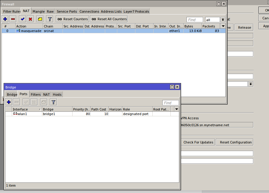

Most probably the problem is the LTE router doesn’t know how to reach 192.168.0.0/24.
First chech on Bridge > Ports if both the wlan interface and the ether interface are there; if so, disable the ether bridge port or delete it, and move the DHCP client to the ether port.
Check Ip > Firewall > Nat. Is there any srcnat rule?
if not, add one:
General tab: chain: srcnat out interface: the ether port connected to the LTE router
Action tab: action: masquerade.
Now all traffic leaving the AP will be masqueraded as 192.168.0.1, an the LTE router will know how to reach the AP clients.
I went through the settings you suggested and they all pre-existed.
Attached is a screen shot from WinBox.
