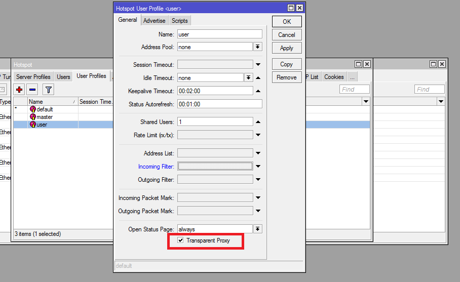

Just so I understand…you will have multiple devices logging in with the same username? Are you using the proxy (/ip proxy) in the router? If you want to use the proxy for one group of users, and not for others, assign different user profiles to each user. You can set which profiles use the proxy in “/ip hotspot user profile”.

I have 2 hotspot user profiles, master and user. With the user profile i set the ‘transparent proxy’ like in the SS, while the master profile the options isnt marked, but oddly enough the proxy blocked my access with both accs while testing.
It works on my hotspot. I just tested it. Insure your web browser is not using its cache to view a recently visited website.
edit: Insure you have the proxy enabled
/ip proxy
set enabled=yes
Then my test was block mikrotik, and it did, but only for that user profile that had the transparent proxy enabled.
/ip proxy access
add dst-host=*.mikrotik.com action=deny
The users with the profile that did not have the proxy enabled could access mikrotik ok.
