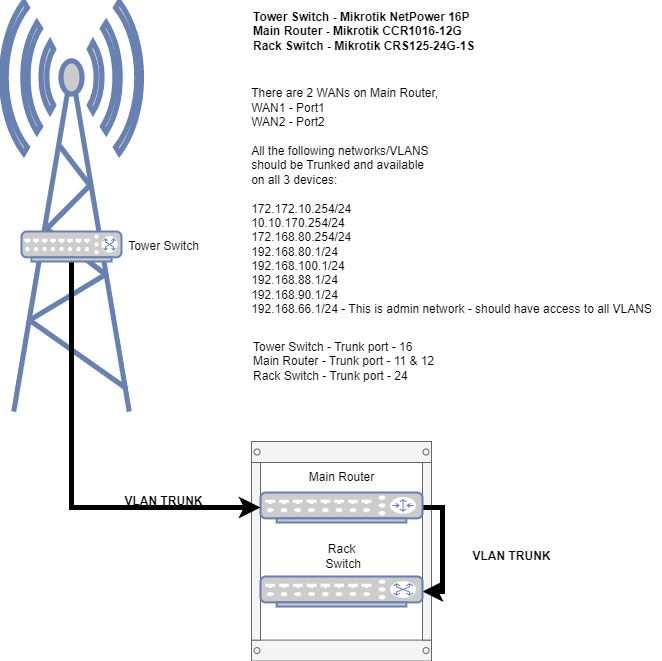

Diagram attached:
I missed that. Nothing immediately obvious, is the cable OK (expected link speed, no errors, etc.).
Yeah, cable is our next step, we will change it soon.
I seems to be fine, but we will test another.
seems to be bad cable, we replaced it with a new one and seems to be working fine now.
