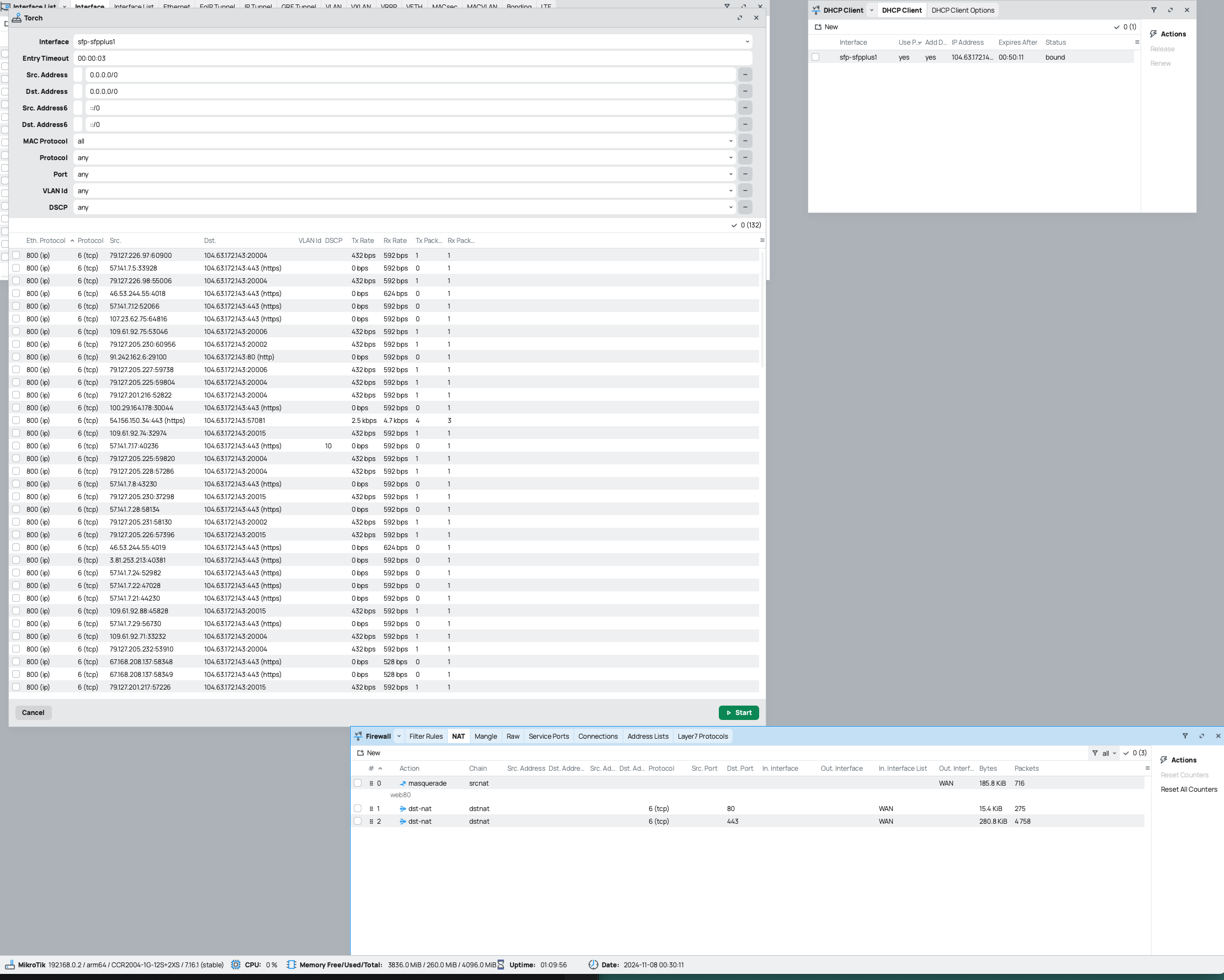

I used Torch and I can see incoming requests (mostly to port 443) - see screenshot. Not sure, how to interpret it.
What do I miss? How can I troubleshoot it?

I added firewalls rules, as suggessted above, and port forwarding still doesn’t work.
Tried few other firewall settings - can’t make port forward to work.
Here is how I see connections on Firewall:
 /ip firewall/connection print
Flags: S - SEEN-REPLY; A - ASSURED; C - CONFIRMED; F - FASTTRACK; s - SRCNAT; d - DSTNAT
Columns: PROTOCOL, SRC-ADDRESS, DST-ADDRESS, TCP-STATE, TIMEOUT, ORIG-RATE, REPL-RATE, ORIG-PACKETS, REPL-PACKETS, ORIG-BYTES, REPL-BYTES
  #        PROTOCOL  SRC-ADDRESS            DST-ADDRESS           TCP-STATE    TIMEOUT    ORIG-RATE  REPL-RATE  ORIG-PACKETS  REPL-PACKETS  ORIG-BYTES  REPL-BYTES
  9   C  d tcp       198.13.84.43:56620     104.63.172.143:443    established  4m6s       0bps       0bps                  2             0       2 468           0
 10   C  d tcp       52.183.22.178:36372    104.63.172.143:443    established  4m25s      0bps       0bps                  3             0       3 507           0
 14   C  d tcp       66.249.73.200:37708    104.63.172.143:443    established  4m         0bps       0bps                  1             0          52           0
 15   C  d tcp       66.249.73.200:55028    104.63.172.143:443    established  4m53s      0bps       0bps                  2             0         104           0
 19   C  d tcp       66.249.73.201:43451    104.63.172.143:443    established  4m36s      0bps       0bps                  2             0         104           0
 25   C  d tcp       66.249.73.201:42575    104.63.172.143:443    established  4m36s      0bps       0bps                  2             0         104           0
 37   C  d tcp       108.172.75.226:52364   104.63.172.143:443    established  4m20s      0bps       0bps                  2             0       2 338           0
 41   C  d tcp       66.249.73.200:59266    104.63.172.143:443    established  4m53s      0bps       0bps                  2             0         104           0
 42   C  d tcp       66.249.73.200:61300    104.63.172.143:443    established  4m53s      0bps       0bps                  2             0         104           0
 53   C  d tcp       66.249.74.78:60332     104.63.172.143:443    last-ack     4s         0bps       0bps                  8             0         416           0
 70   C  d tcp       3.142.54.202:39828     104.63.172.143:443    syn-sent     0s         0bps       0bps                  4             0         240           0
 71   C  d tcp       57.141.7.22:52794      104.63.172.143:443    syn-sent     0s         0bps       0bps                  4             0         240           0
 72   C  d tcp       3.142.54.202:6209      104.63.172.143:443    syn-sent     0s         0bps       0bps                  4             0         240           0
 73   C  d tcp       57.141.7.6:53342       104.63.172.143:443    syn-sent     0s         0bps       0bps                  4             0         240           0
 74   C  d tcp       57.141.7.27:34566      104.63.172.143:443    syn-sent     0s         0bps       0bps                  4             0         240           0
 75   C  d tcp       3.219.81.66:46257      104.63.172.143:443    syn-sent     0s         0bps       0bps                  4             0         240           0
 76   C  d tcp       54.85.7.119:13306      104.63.172.143:443    syn-sent     1s         0bps       0bps                  4             0         240           0
 77   C  d tcp       216.244.66.247:35586   104.63.172.143:80     syn-sent     1s         0bps       0bps                  4             0         240           0
 78   C  d tcp       57.141.7.3:40228       104.63.172.143:443    syn-sent     1s         0bps       0bps                  4             0         240           0
 79   C  d tcp       57.141.7.28:41220      104.63.172.143:443    syn-sent     1s         0bps       0bps                  4             0         240           0
 80   C  d tcp       184.73.195.18:56731    104.63.172.143:443    syn-sent     1s         0bps       0bps                  4             0         240           0
 81   C  d tcp       57.141.7.1:35404       104.63.172.143:443    syn-sent     1s         0bps       0bps                  4             0         240           0
 82   C  d tcp       57.141.7.15:37358      104.63.172.143:443    syn-sent     2s         0bps       0bps                  4             0         240           0
 83   C  d tcp       57.141.7.25:49674      104.63.172.143:443    syn-sent     2s         0bps       0bps                  4             0         240           0
 84   C  d tcp       57.141.7.16:38876      104.63.172.143:443    syn-sent     2s         0bps       0bps                  4             0         240           0
 85   C  d tcp       54.221.203.24:5692     104.63.172.143:443    syn-sent     2s         0bps       0bps                  4             0         240           0
 86   C  d tcp       57.141.7.19:53314      104.63.172.143:443    syn-sent     2s         0bps       0bps                  4             0         240           0
 87   C  d tcp       54.147.182.90:54458    104.63.172.143:443    syn-sent     3s         480bps     0bps                  4             0         240           0
 88   C  d tcp       57.141.7.23:54898      104.63.172.143:443    syn-sent     3s         480bps     0bps                  4             0         240           0
So, I see that
  • connections on port 80/443 correctly getting to DSTNAT
  • but never gets to the state " S - SEEN-REPLY; A - ASSURED"
What else can I do?
