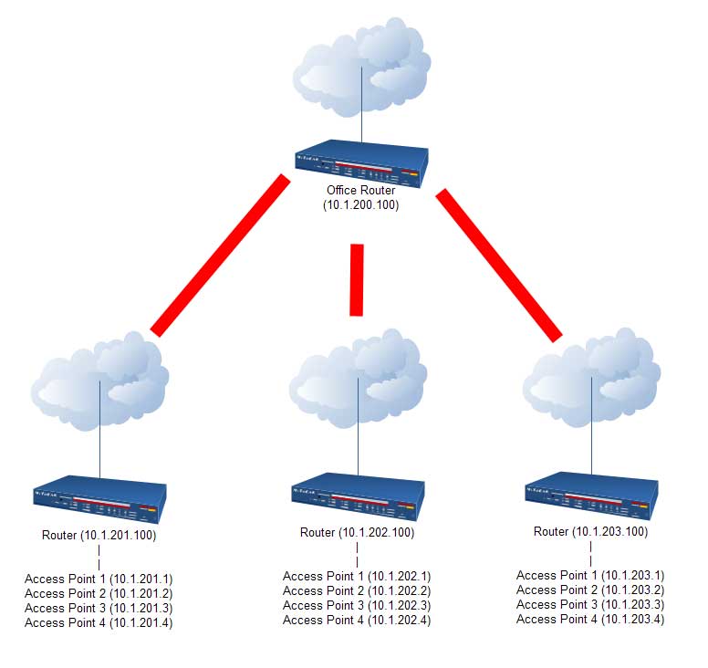

I am new to Dude Monitoring and need some suggestions on what is the most efficient way to monitor these devices.
Basically, we have multiple remote locations, where we are using RouterBoard and Access Points (varying numbers). All the Remote Routers and Devices have different IPs (as shown in the diagram).
I want to monitor all the devices from my office location.
Should I connect my office router to the remote routers using VPN (pptp or l2tp) and then use Dude to monitor the APs? Or does anyone have any better suggestion?

I suggest you set up a Dude agent in each remote site. See my post in this topic => http://forum.mikrotik.com/t/dude-agent-again/44012/1
