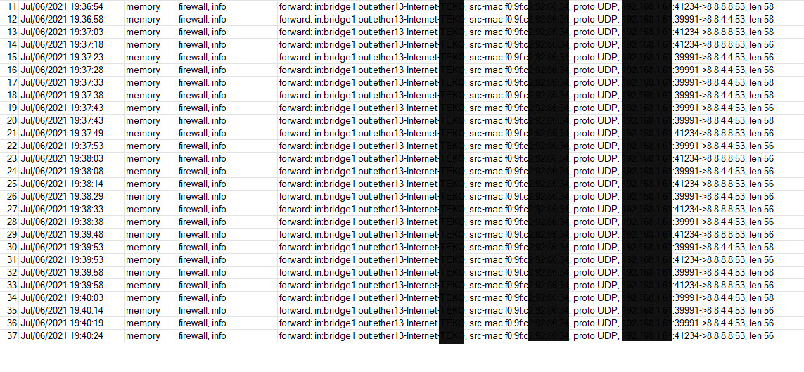

Hello community:
I am having this issue on my router, would this be some kind of flooding? How can I solve this issue, I would appreciate any help please.
Why do you consider up to 10 DNS queries per minute a “flood”? Unless this happens even when nothing is connected to the LAN of that router, that’s a pretty normal traffic.
So what makes you believe it is unusual?
You obfuscated the screenshot a tad too much. But src-mac printed starts with F0:9F:C and if it continues with “2”, this means some Ubiquiti in your LAN is actually misbehaving.
And it does look suspicious, requests are highly periodic. Usual usages don’t look as periodical.

Thanks for your fast replay. These PrtScreen provided is just a small part, but it’s constantly giving me these msgs nonstop suddenly is stops for a few and then it continues.

Yes, it does, it starts with f0:9f:c2:92

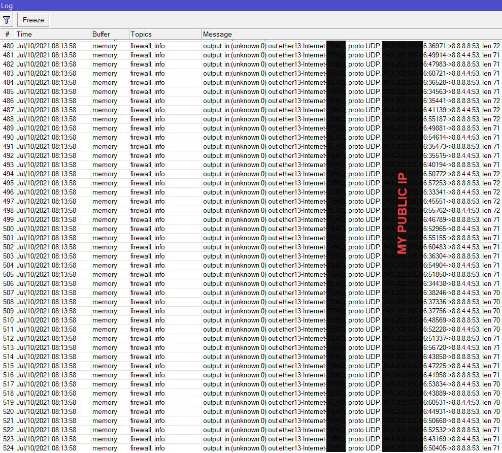

The previous PrtSc was originated from a UBNT equipment and it’s down right now, so my bad. The correct screen is this one posted now
Okay, so if I get you right, you know you’ve got some issue somewhere in your network because your public IP is getting blacklisted, but you don’t know what went actually wrong and these DNS requests are just the first thing you’ve noticed so far?
On your last screenshot, the packets to Google DNS servers are sent by the Mikrotik router itself, but it presumably acts as a DNS proxy for the internal network, so it doesn’t say much.

Looking at the ports and times it seems to be repeats of each DNS request by the same client. It seems that there is no reply received.

The routerboard send requests to Google because you set 8.8.8.8 and 8.8.4.4 as DNS…
What I deduce from what are wroted and what are NOT wroted on your export:
You block all internal DNS traffic of RouterBOARD,
but you still have some DNS to be resolved from routerboard.
Time-Zone auto detect, /interface detect internet, /ip cloud update, and THE DUDE active try to resolve all IP to hostname
and requests are tried over and over because internal DNS resolution is blocked by your rules.
This is why you have all this log on your device on that rate insistence.

I did read your post and disabled the drop DNS request. It's not showing the long logs anymore :slight_smile:
