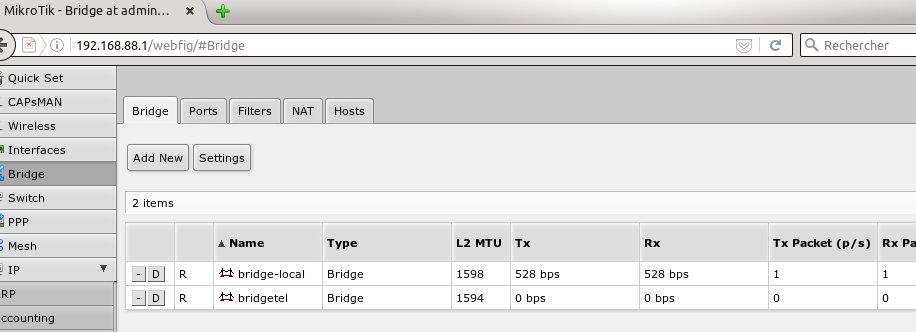

Many thanks for your responses. I have read carefully and understood I need to do this:
/interface vlan add name=ETH5-V101 vlan-id=101 interface=ether5
/interface bridge add name=bridgetel disabled=no
/interface bridge port add interface=ETH5-V101 bridge=bridgetel
/ip address add address=192.168.89.254/24 interface=bridgetel

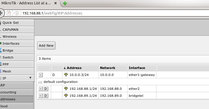

Here’s the results:
When I don’t change the 802.1Q/VLAN setting and connect the phone to ETH5, it works and get IP 192.168.88.225
When I change the 802.1Q/VLAN setting to 101, restart and connect the phone to ETH5, it doesn’t works and gets no IP.
I have provided screen capture to show you.
Any idea of what is wrong?
Thanks,
Marc.

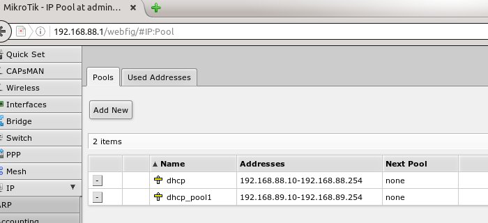

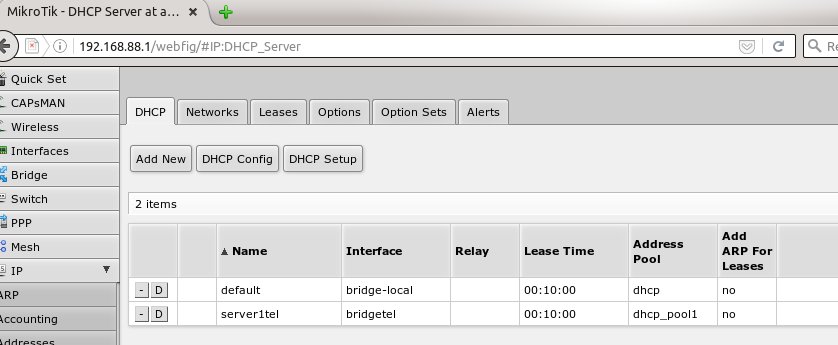

Hello again,
I have changed the last line from:
to
/ip address add address=192.168.89.1/24 interface=bridgetel
and I went into DHCP server and pool as you can see in the new screen captures.
Now the phone gets an IP 192.168.89.247 but it is not able to communicate with the outside world.
Any idea of what is missing?

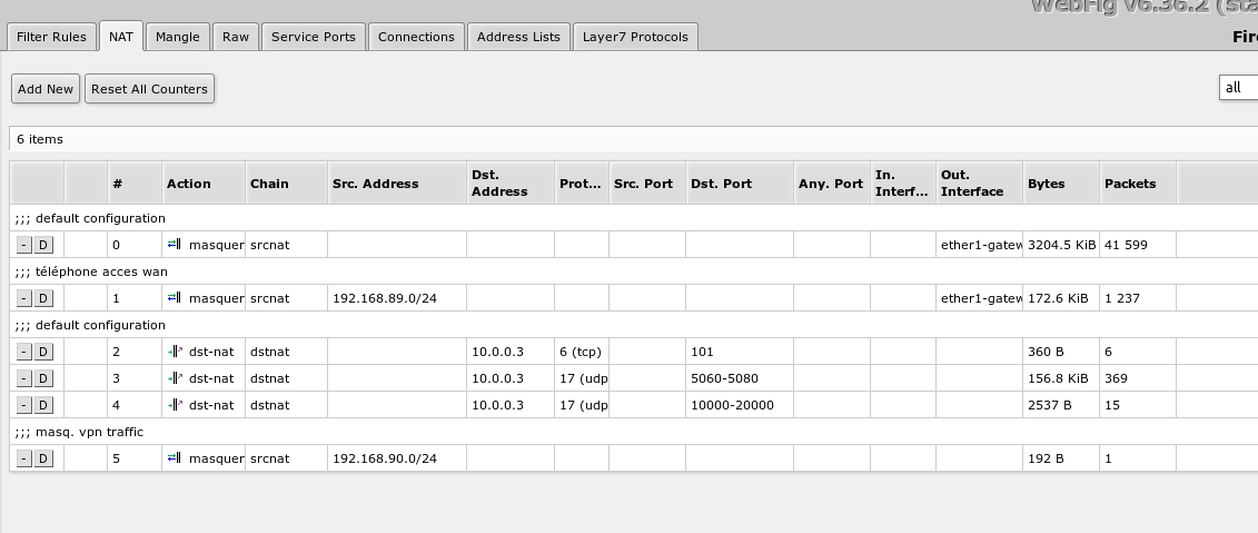

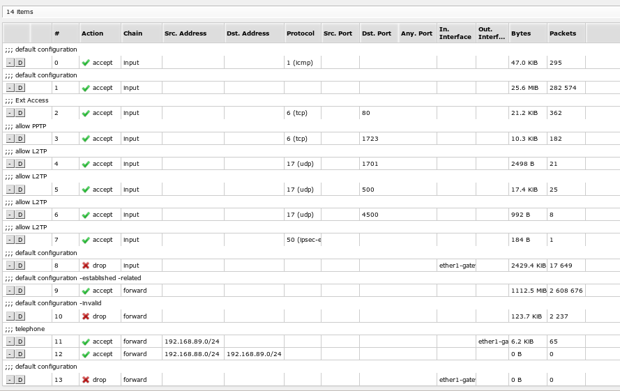

Have You srcnatted bridgetel? It is separate interface, check firewall rules for it. In general they should be the same as for bridge-local.
Hello karlisi,
Many thanks for your response. I don’t see any natting specific to any bridge. But I think I have done it although it may not be done perfectly right. Please see attached pictures…
You may notice I have added a rule (12) for being able to communicate from my PC to the phone. But since the phone only gets an IP and remains unable to communicate, it is useless.
Can you see something wrong somewhere? Any other ideas?
You have no idea how much time I have spent trying to do this. All my attempts failed. :frowning:
Regards,
Marc

Is your DHCP server supplying a router address
Go into DHCP-Server → Network and check
There is probably the default entry for 192.168.88.0/24 with the corresponding router address (probably called gateway).
Add a new network entry for the 192.168.89.0/24 network with the correct gateway.
Hello all who helped on this,
Many many many many many thanks. The last comment from Rudios made the difference. I will come back later with a topic summary on how to do this in the hope of helping others.
