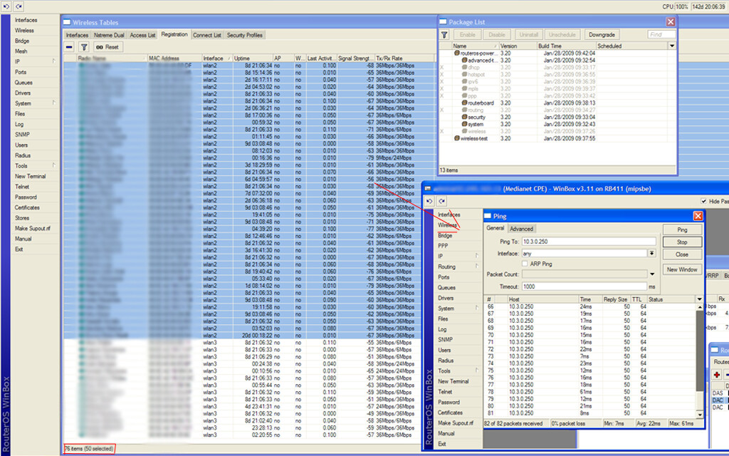

Hello, in my case I have several nodes with 40 - 50 - 60 CPE Nstreme enabled ping is 20-300ms, now I’m trying to 1 node has 50 CPE Nanoloco5 and disabled Nstreme see is that ping 2-7 ms.
Mikrotik’d do something Nstreme to support more clients and better quality of ping ![]()
Tell me if you get better results without wireless test..
50clients connected

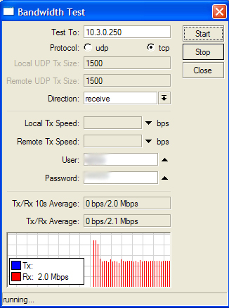

2mbit offered
