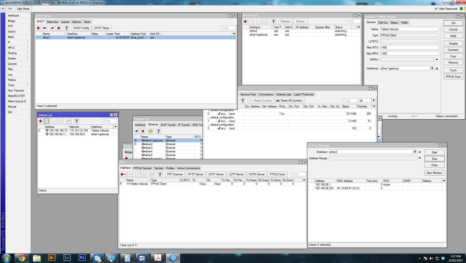

I am still struggling to get this all working. I get connected to my Telstra (Aus ISP) Fibre connection here no worries, it’s authenticated and everything. I have setup the DHCP server on the ethernet1 port which is the port which is connecting the PPPoE. I have also made sure the address 192.168.88.1/24 is assigned to ether1. As you will see in the screenshot I have provided the PPPOE connection is getting a dynamic address. However when I added either ether2 or ether1 as a client it just sat there searching bearing in mind I new ether1 wouldnt work since it is the server. However either2 was the concern, I did however get an ip assigned to me from the router which was .253, so it is assigning ip’s.
Still I have the image on my link near the time saying its got connection to the network and internet yet I don’t…
Also if I use the tools on the router to say test connections outside of the network nothing works, so I wonder if I am actually connecting to the internet?
When you talk about the 192.168.88.0/24 being masqueraded are you talking about a NAT firewall, because I did that as well and it did not help either.
Maybe there is some sections specifically I need to read up on to fix these problems, but I don’t know exactly where to start reading to resolve this issue I am having…
Thanks in advance to anyone who gives some ideas or advice!

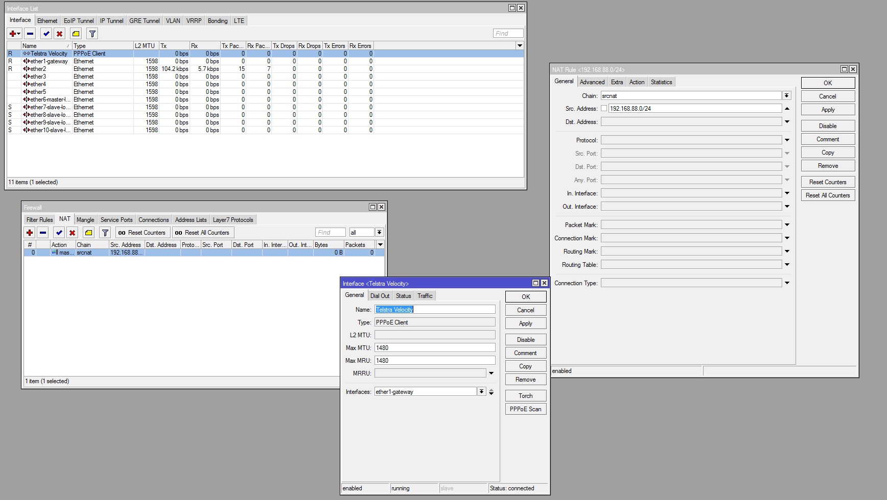

Hey Josh,
Thanks again for your help, here is the screenshot of my interfaces, firewall nat and I even got one of the nat rule I had attempted to make as well. This is one is being masqueraded in the action tab.
But I have probably done this all wrong…
So ether1 is WAN port and should have pppoe client on it.
Your LAN port or ports should be on a different port.
So change the 192.168.88.1/24 to ether6 or whatever port that you want to be your lan port.
It appears that in your screenshot eth6 is master local and eth7-eth10 are slaves to eth6. So in short it like you have a switch plugged into eth6 and ports 7-10 are the switch ports.
So for testing move the 192.168.88.1/24 eth6 and then remove dhcp server and then setup a new on on eth6 and verify that the firewall nat is masquerading 192.168.88.0/24 and now when you plug into eth6-10 you should get an address and surf. Please verify that you have a 0.0.0.0/0 route to your pppoe gateway in ip route.
