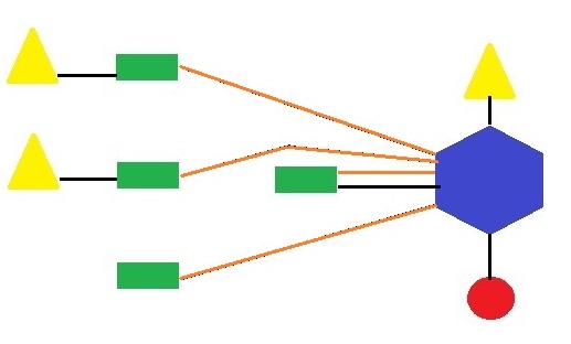

Hi, I need to build up a network for a restaurant, it consist of internet access, a main switch where all terminals/office PC are connected and hotspots. Each hotspot should broadcast the main local office network, plus it needs provide internet access for guests. For guret access there will be necessary a second IP domain managed by the internet router (provided by provider) on the same interface port, that will allow access only after identification process. I need to know if these configurations may be valid, please correct me if Idescribing it I’ll be wrong, have a look:
Simple configuration, 3 mikrotik (on edge) routers are connected to a CAPSMAN which broadcast the main and secondary IP domain on 2 different SSID, on their 2nd LAN port there is connected a Terminal (to the main IP domain, yellow triangles). On the gateway interface of CAPSMAN there will be both IP domains with gateway (the internet access, red circle), by a simple switch (blue hexagon). The brown links should be configured as VLAN, each VLAN should be assigned to a different bridge, if I understood correctly.

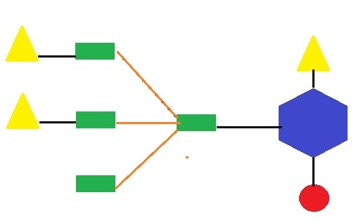

A second possible connection is this:
THe CAPSMAN will output the VLAN to the switch too (does this work on a unmanaged switch? or does it dicards pakets?), this is more convenient because only 2 wires should be placed for the router, and in this case I can install many more hotspots without the limitation of the 4 availabe ports on router. Can it work?

I’ve just read that an unmanaged switch will not accept VLAN packets since they are 4 bytes bigger than standard, so the last solution will not be possible. I’ll buy a 8 port router in case I need more than 4 edge hotspots.
By the way, should I really need to use VLANs in such process? 2 different IP domains may be present in the same bridge, but when I tried that with CAPS I had several problems, it worked only on CAPSMAN
The recommended setup for Mikrotiks with VLANs is to use a single VLAN-aware bridge, there is a good primer in the forum http://forum.mikrotik.com/t/using-routeros-to-vlan-your-network/126489/1
If the wired client connections (what you have called terminals) are on one network you can use CAPsMAN forwarding to segregate the wireless network instead of VLANs, although this does potentially reduce throughput and increase CPU load on the APs and CAPsMAN controller due to the traffic encapsulation it uses.
VLAN-tagged traffic is just a different ethertype and slightly larger packet, which although more than the original ethernet standards, is handled by many unmanaged switches unless they use very old chipsets.
It isn’t clear what you mean by “second IP domain managed by the internet router” - is this a second IP address on one subnet, a second subnet provided on a different port or VLAN on the internet router, or something else.
Thanks for answer, the internet router will provide 2 subnets on one link (I think that is possible) with 2 gateways, one is for office, second (filtered by authorization) for guests.
So you tell me I can avoid use VLAN, on CAPSMAN I can connect only ethernet1 to the main switch, assign every IP subnet to a different bridge, and in CAPS setup associate office SSID to office bridge, public SSID to public bridge. Output the CAPSMAN to the same eth1 (internet connection will be only 20 megabits, so one port can do physically all), configure other AP with an IP of the office subnet, and accept CAPSMAN from the main router IP..
Does it work like that?
My experience (never solved yet) is that not using VLAN but 2 IP subnets on the same bridge created problems on the remote CAPS, only if I disable the second SSID (from CAPSMAN) the main first worked.. that was really strange, never had time after to fix it, but one day I should

Using logic, if I can guess, there are needed 2 bridges on the CAPSman, assign office’s subnet to default bridge and guest’s subnet to a new one, both bridges should be linked to eth 1 (connected to the internet gateways) to receive traffic, in the CAPS configuration the office SSID will be assigned to the main office bridge, the guest’s SSID to the other bridge.
In the first case/scheme (CAPS directly connected to the CAPSMAN by eth2, 3, 4..) the other ethernets ports should be assigned to the office bridge only, on CAPS there will be only the default bridge with an IP from the office subnet. All eth ports on the sabe bridge so I can connect terminals too on the same ethernet broadcast domain.
Maybe, to semplify the wiring, I can connect CAPS to the switch without change the config, and the CAPSMAN will use the eth1 also for sending CAPS the encapsulated traffic, with advantage that capsman will not concentrate (level2) all terminals on one only uplink, only SSIDs traffic will flow on it.

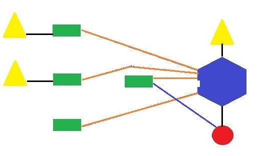

I’m really glad for your kind help! Yes yoi said something wise.. I can’t have 2 subnets running on one link due of DHCP issues.. so my question is, can we forget about VLANs and consider this circuit:
The CAPSMAN router is connected with eth1 to the switch, as all other CAPs, and on eth2 directly to the internet access for the guest’s subnet. I’ll create a new brigde assigned to eth2, now can I add the slave CAP SSID to the bridge2 and output all CAPSMAN to the eth1? I suppose yes.. cause CAPS don’t mind on level2 but on target IP..
Other CAPS will have the main subnet configured.. so all other LAN ports may be used for terminals..
No, one VLAN aware bridge. Then make the port connected to the guest network on the router (blue line) an access port for the guest VLAN. As the unmanaged switch may not pass tagged traffic make all the other Mikrotik ports access ports too, and use CAPsMAN forwarding to encapsulate the guest traffic.

CAPSMAN should be used also for the office subnet WiFi, maybe I’ve not explained me well.. I need 2 SSID with CAPSMAN function (roaming between AP), the master SSID connected to the office subnet, the slave SSID to the guest subnet. I also need the office subnet on the ethernet ports of APs.
In the link between CAPSMAN and CAPS should be capsman encapsulation + office subnet traffic..

First, CAPsMAN is a way to make your life easier when provisioning multiple APs and to reduce the requirements on the transport network capabilities. It is not necessary to make roaming possible, nor does it make it easier or faster. The stations (clients) may roam among individually configured APs that use the same SSID with the same ease (or complexity) as among APs centrally configured by CAPsMAN.
Second, I’ll try to rephrase @tdw’s last post and extend it a bit. With standalone APs, or with CAPsMAN-configured APs with local-forwarding set to yes, you need one VLAN per SSID on the path between the AP and the central router to keep the networks isolated, which means that the transport network must support VLANs. I haven’t seen a “dumb” switch which would not handle VLAN-tagged frames (i.e. 1518-byte ones) yet, but better safe than sorry. So if you use local-forwarding=no, the frames from the APs get transported to the CAPsMAN device encapsulated and encrypted in UDP with an internal information of the wireless interface they belong to, so VLAN tagging on transport between the AP and the CAPsMAN device is not necessary, and the eventual conversion of wireless interface (SSID) to VLAN ID, if necessary at all, can be done at the CAPsMAN device. So you can use a dumb switch to connect more APs to the CAPsMAN device if the bandwidth allows.
But maybe the VLANs may be omitted completely - if I got you right, the guest SSID will be L2-transparently connected to the LAN side of the ISP gear, which will provide DHCP etc. to the guests. So on the CAPsMAN you can use a dedicated bridge, let’s say br-guest, and make the wireless interfaces with SSID guest member ports of this bridge along with the Ethernet port connected to the ISP gear. And the wireless interfaces with SSID “company” can be made meber ports of another bridge, on which the CAPsMAN device will provide DHCP, routing etc.
