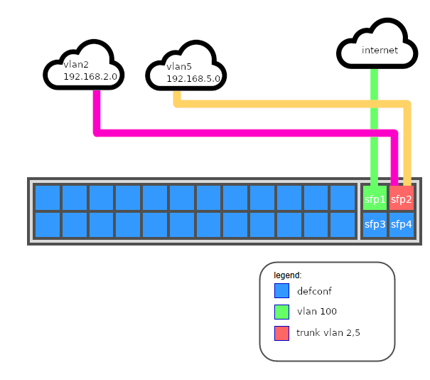

Hi, I’m quite new in setup Mikrotik devices here is my setup.
model: CRS328-24P-4S+
current-firmware: 7.9
I’ve also a ‘cAP ax’ but it’s not the point here.
I’m looking for a documentation on how to implement vlan on bridge with filtering on .
For general environnement, my switch router name ‘SwRo’ is directly connected to the ONT of my internet provider (no box anymore).

Next I setup a Trunk port with 2 tagged vlan.
I did my setup following this guide : http://forum.mikrotik.com/t/using-routeros-to-vlan-your-network/126489/1
post #2 : Switch with a separate router (RoaS) : section Router Configuration at a glance.
	add frame-types=admit-only-vlan-tagged name=bridge-v vlan-filtering=no
/interface vlan
	add interface=bridge-v name=VLAN2 vlan-id=2
	add interface=bridge-v name=VLAN5 vlan-id=5
/interface bridge vlan
	add bridge=bridge-v tagged=sfp-sfpplus2 vlan-ids=2,5
	add interface=VLAN2 list=VLAN
	add interface=VLAN5 list=VLAN
	add address=192.168.2.1/24 interface=VLAN2 network=192.168.2.0
	add address=192.168.5.1/24 interface=VLAN5 network=192.168.5.0
On the other side I plug a FreeBSD host with Jail on Vlan. All seems to work I can ping internet or anyone in my lan from booth Vlan.
What I wanted is to isolate VLAN2 and VLAN5 of anyone else. But they need to be able to go to internet.
For this I had to change on bridge-v vlan-filtering to yes.
But when I did this on booth vlan I can’t even ping there gateway (192.168.2.1 / 192.168.5.1).
I think I add to add some rules in : /interface/bridge/nat and /interface/bridge/filter/ .
I’m looking for documentation about this.
