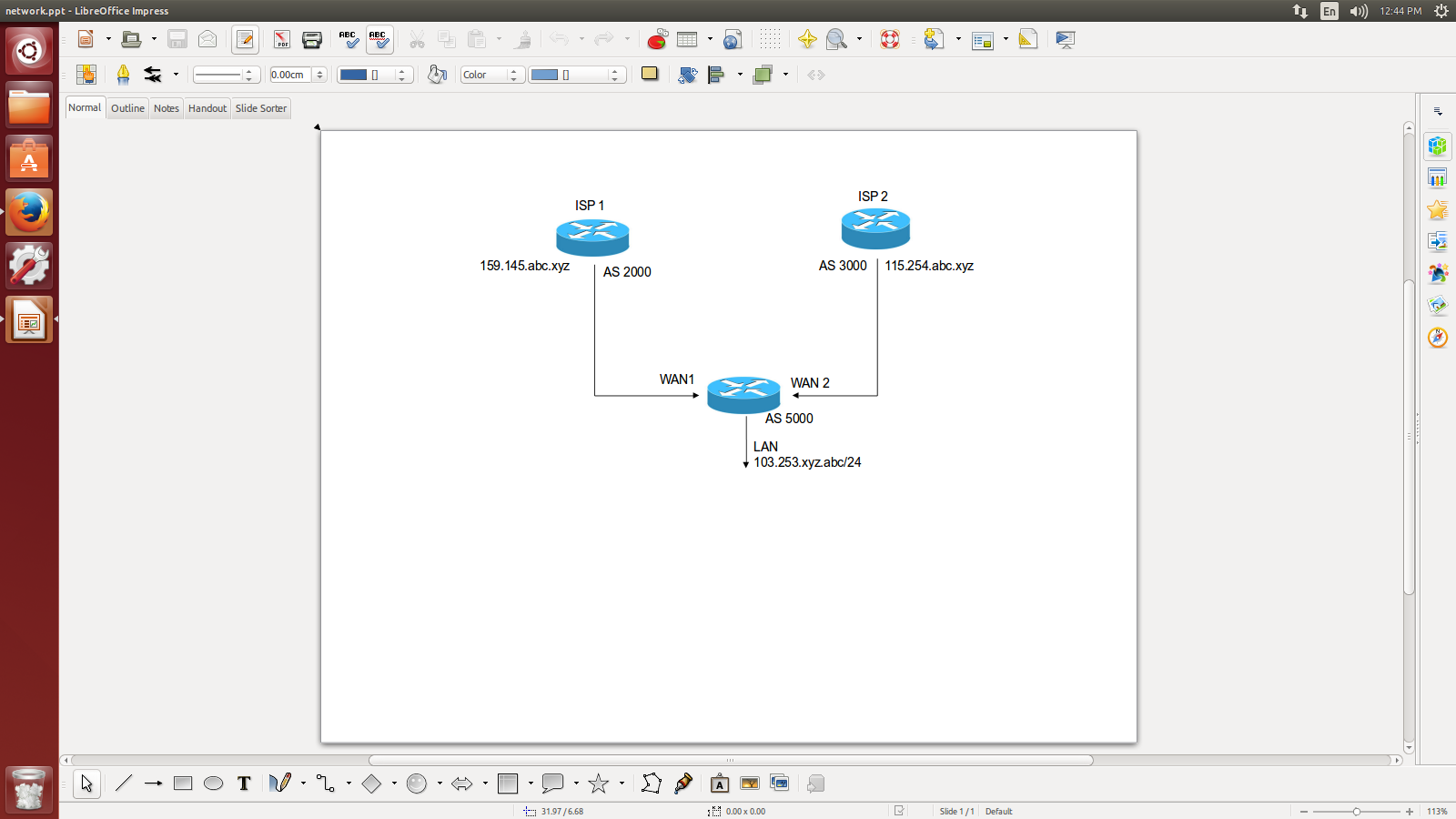

I have two internet connectios from 2 diffrent ISP’s , with 60Mbps from ISP1 and 155 Mbps from ISP2. I have a CCR 1036-12G-4S-EM with ROS ver 6.20 .Both the ISP’s have enabled full routing tables.I want to BGP peer with both ISP’s with my ASN.I have two /24 IP prefix.Is it possible to configure BGP load sharing with both the ISP’s over one /24 IP perfix ,if so please let me know the configuration or let me know of any other best alternative .

Thanks for the link, strated implementing the process . Just want to know is it passible to use policy based PCC load balancing in BGP environment with 2 BGP peers as in the earlier network diagram.
