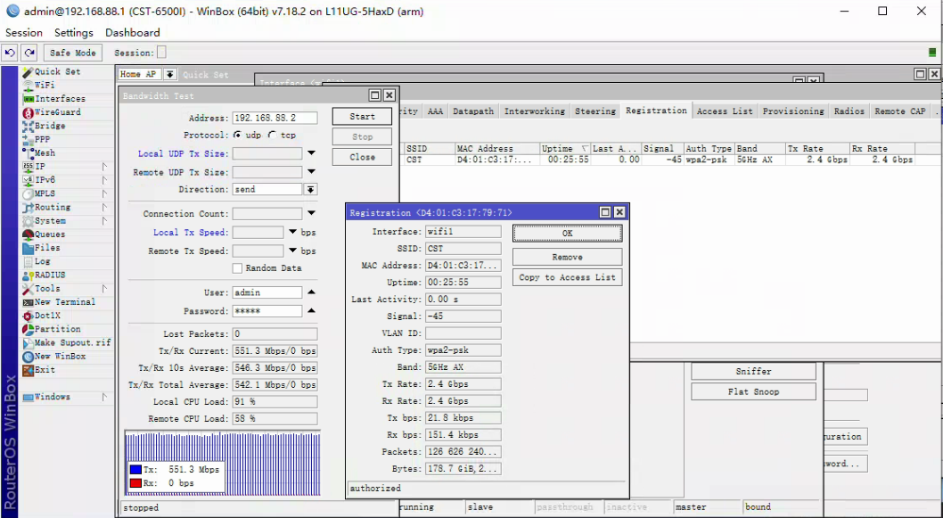

This is static state

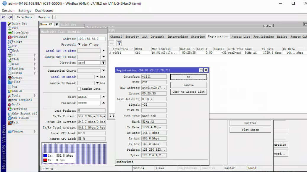

This is the test status
At what rate are the devices connected? Aah, you just added a post, 2.4Gbps.
BTest is a great tool, just not for this purpose. It is CPU heavy, have you checked cpu load during test?

Btest is a bad way to do tests, because it needs to “create random data” on the device, and this loads the CPU.
Just do normal iperf tests from one PC to another PC, so that connection goes through the router.

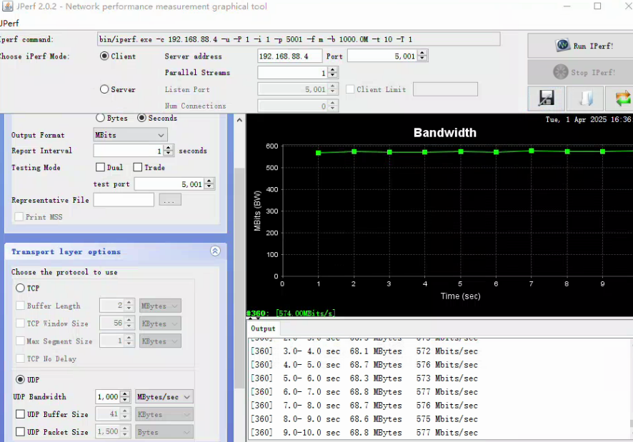

I connected the PC and used iperf to measure more than 100 mbps. My network cable may not reach Gigabit. It is difficult to replace the network cable at present, so I thought of using bandwidth test. I just want to test whether the wireless bandwidth can reach Gigabit.
So the best way is to replace the network cable and use iperf test, is that right?
Yes! :sunglasses:
ok,thanks
Using jperf, the bandwidth still cannot reach 1000mbps
