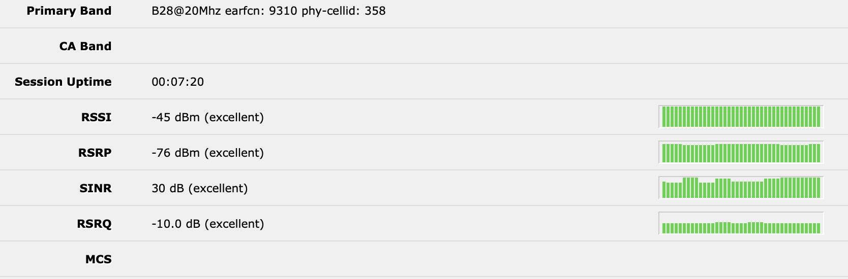

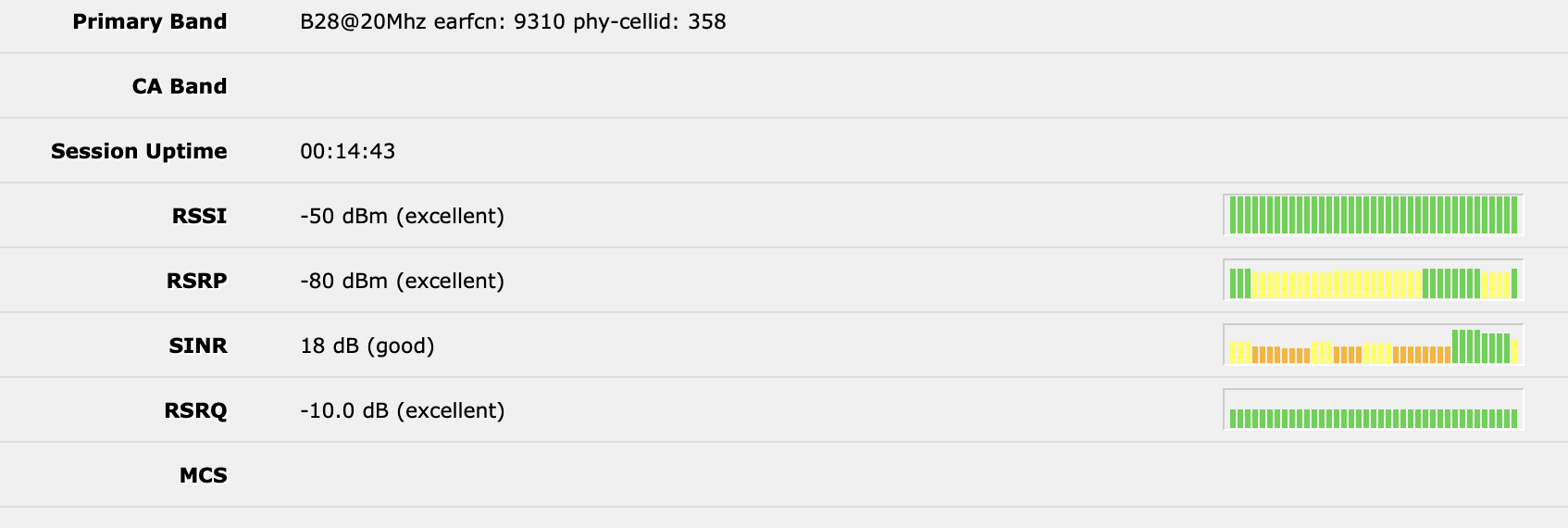

Attached is details of my signal strengths. Is it normal for SINR to be so up and down? Is this a symptom of a poor RF connection or of an overloaded tower?
Signal strength (RSRP) variations and associated SINR variations may be caused by using internal antennae. That PCIe card doesn’t have much space while B28 (800MHz) does require quite physically big antennae - dipole size would be 37cm. And no, RSRP of -80dBm is not exactly great, if cell tower is under load this likely means you get less than “fair share” of throughput, most cell towers are configured to (slightly) prefer clients with better radio conditions as overall tower throughput can be much higher than it would be when using “round robin” schedulling of resources.
So yes, your LTE connection would be (much?) better if you connected (decent) LTE antenna. If you decide to get one (pair!), make sure it’s got decent gain figures in low frequency bands - high gain in upper frequencies won’t help in your case.

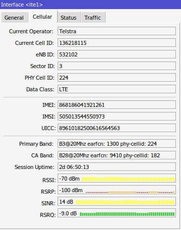

This week I set up an LHG dish with an EP06-E (in MBIM mode and ROS7.6) from Duxtel connected to a Telstra tower 16km away. It’s using B3+B28 and at the time of install was getting 25M/25M with Speedtest. The signal is pretty ordinary but it’s good enough for the job.
I did have trouble initially while I was seeking a signal that it locked to a closer B28 only tower and the signal and throughput was unstable and under 2Mbit. I don’t think an LHG dish is big enough for 700MHz and I suspect the B3 (1800MHz) is doing most of the legwork on this link. Maybe the antennas at the focus of the LHG aren’t optimal for B28 either.

Note that only MBIM mode (which you need ROS7 for) will show you any CAs being used. The default USB-ECM mode the Quectels seem to come set up with won’t without using an AT command to illicit a response.

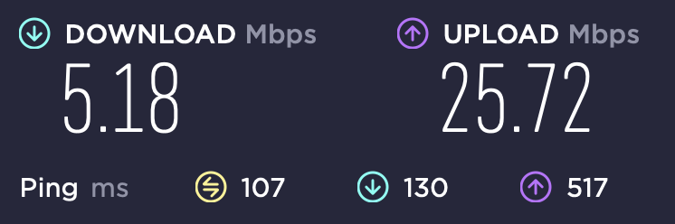

Signal strength Definitely improved. See attached screenshot.
Speed however not much better.
Interestingly I tested speed with the iPhone and the mikrotik at the same time and both were poor. <10mbs. Uploads on both remain good (at approx 25mbs).
From this testing Im thinking my speeds are currently limited by capacity at the tower, not my antenna(s).
Yeah try at sometime between 12am and 6am and compare downloads. An extra antenna might get your the other “chain” and improve download speed. Put the antennas at +45 and -45 degrees like the double Yagi in the pic above, not horizontal and vertical.
In theory, second antenna should double downlink speeds in optimum radio conditions and improve stability in bad radio conditions.
And I concur with @UpRunTech (as I already wrote): test during late night, those are times when most cell towers are least congested …
