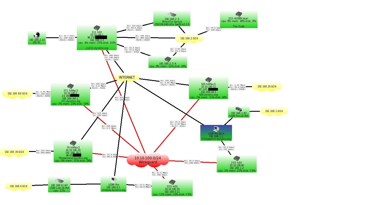

I’ve created the following so far. Each column is a different location (all connected via VPN).

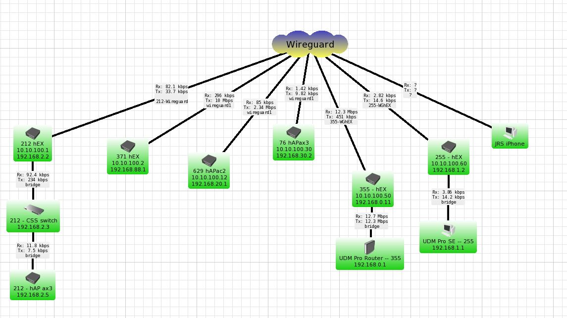

Use the + button to add a static item or network. With network, it actually doesn’t matter what you use as the range, so could be 0.0.0.0/0 – it just used for display. Then you can use the + to add a link, and draw them between those devices and network. It will let you pick what interface you want it tracking.
I think the trick is the “link” needs two ends to be usable & and without the link… it’s not tracking traffic, which is likely what you want. The links are one-to-one, but you can create multiple network/static objects if you have more than one interface. Those can have labels like WAN etc. to clarify what where the links go.

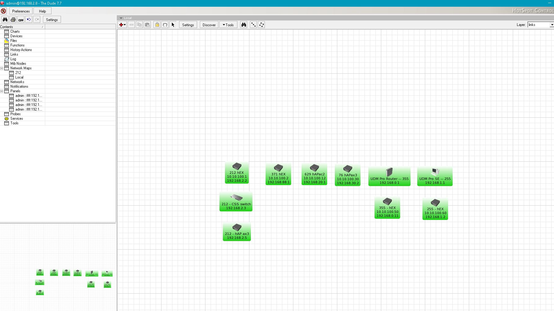

While I’m studying what you wrote, I noticed an annoyance:
Every so often (possibly associated with a scheduled re-scan/rediscovery), the elements on my map get rearranged to just about sit on top of each other (all squooshed together).
Anything I can do to prevent this?
Not a great one. But do the discovery once is what I do – long enough to populate them but since they typically have to get configured and really don’t want everything monitored anyway. But I can’t say if there is actually some option to organize them. It may re-map them if it finds a new device, but really dunno.
So Dude discovered a whole bunch of links and added them to the map (which is great).
But, now I don’t understand exactly what these links mean.
I created a Network items called “Wireguard” with 10.10.100.x and 192.168.x.x and put it in the center.
I combined the duplicated MT routers that have an address in each of those subnets into a single device.
I created links with throughput on the wireguard interfaces. And links between the MT routers and other other infrastructure devices at each location (switches, AP, Unify UDM routers).
I then created Network items for each local subnet (192.168.0.x, 192.168.1.x, etc.) and a link from each of those to the local devices.

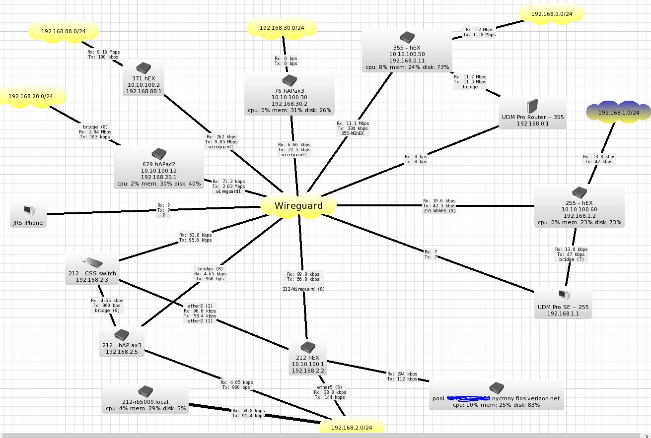

Then Dude added more links.
Any suggestions on making this more consistent and useful?
Thought I’d share the latest version - yes, I’m finding this super cool.
Very cool. Yeah once you get a hang of the model, it works. Used this for a while, and Dude is limiting in someway… but it’s why I have time to comment on the forum :wink:
