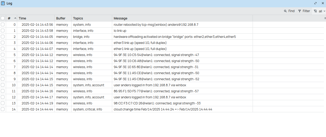

I rebooted the device, ran the tests and looked at the log. Nothing out of the ordinary - have attached a screenshot. Only thing that peaks my interest is that I have noticed that every time I reboot, it has to adjust the cloud time. Is that normal behaviour?

Yep. Those logs are normal.
The “cloud time” thing is also normal. These devices don’t have a proper (external, battery-backed) RTC, so they lose a few tens of seconds at each reboot.
